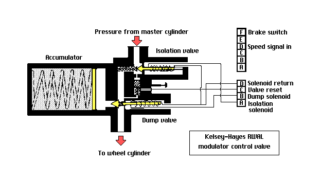

The RABS valve will never lock the back wheels. The passages for the line going through are extremely small a clog with rust..
http://www.aa1car.com/library/abs_kelseyhayes_rwal.htm
The most scary thing that can happen, (and yes it happened to my truck) Air that's trapped will expand and cause the back brakes to lock up and or drag. Be like smoking hot! usually just the right rear,

Thanks Denisefwd93. Yes, I am on a mission and looking forward to celebrating the end result of all this pain and frustration lol. I have the time for trial and error. I’m going to remove the valve and clean it. If it fails, I’ll buy a refurb and report my results. Thanks for the response and pic much appreciated.

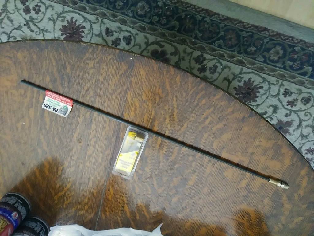

Will it fit???
I've been most of the day going back and forth exchanging to find a one!
According to specifications I found on AutoZone's site for the master cylinder:
Master Cylinder Port Sizes:Primary M10x1.0 , Secondary M12x1.0
However, I'm not happy with AutoZone.
I did get the tube & fittings at AdvanceAuto. (Their website listing, does NOT provide the port sizes for the connections, go figure) but they have rack with all kinds of tubes and fittings.
The trouble is I've not been able to find list or website or reference to cross reference different size brake fittings for different vehicles using metric and USA. and, apparently there's no way to learn except by trial and error.
But it's a fact, Ford uses metric and American sizes on their brake lines.
Follow up: Replaced RABS and all rear brake lines. All works great as it did when new. I had to cut off the brake lines going into the old rabs as they were rusted on. Removed bed to access and remove old rear lines, including the rubber flex line attached to the axle. I bought a 25’ steel brakeline roll and ran a custom fit (10’) line from rabs to the rear axle where it connects to the flex line. It was a PIA removing old lines and rerouting but doable. Same with line from MC to rabs. There’s not a lot of room to wrench on lines to rabs. Just tedious. Bled RR, RL, FR,FL. Started truck and no lights. No Red Brake Light and the Yellow abs went off after 3 secs. So a bad rabs will illuminate both red brake and yellow abs at same time. A red solo brake light indicates low brake fluid. This was confirmed by dealership. Thanks to all for your help and feedback. Job done! Next, replace shocks, rust prevent frame with POR15 and replace trans downshift cable that’s on order. The line is damaged from resting on exhaust pipe uggggg.

Follow up: I bought a 25’ steel brakeline roll and ran a custom fit (10’) line from rabs
I would have chosen the nickel/copper lines over the steel. Easier to work with and no rusting. My plow truck (03 dakota) hasn't been washed in 3 years and the n/c lines look like new.
