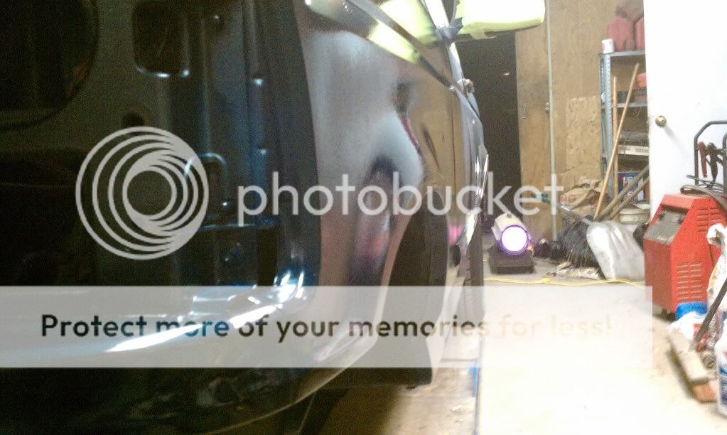

As you all know i sold my baby (the ranger not the real one) and have been working on the 150 here and their so i thought i would get back into the swing of things and post some pics of wat ive done in the past couple of weeks... and let the pics begin...

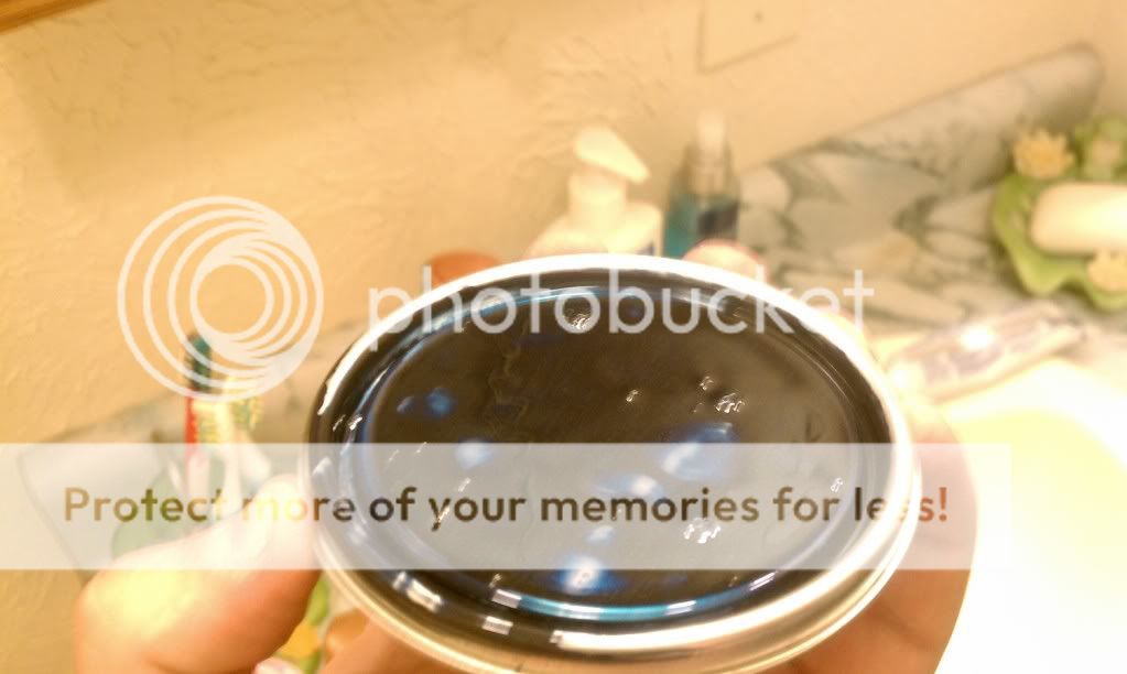

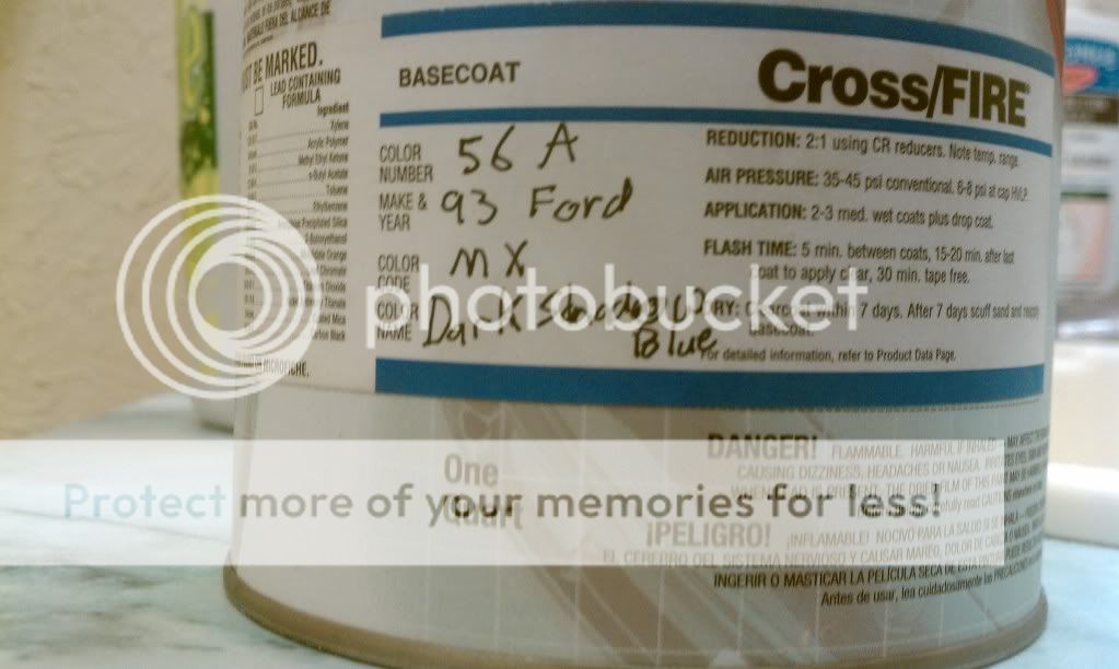

The paint
The match and yes i mixed it myself

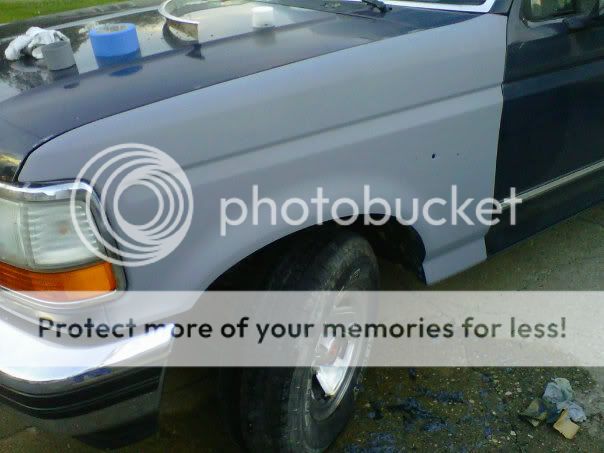

wat i started with

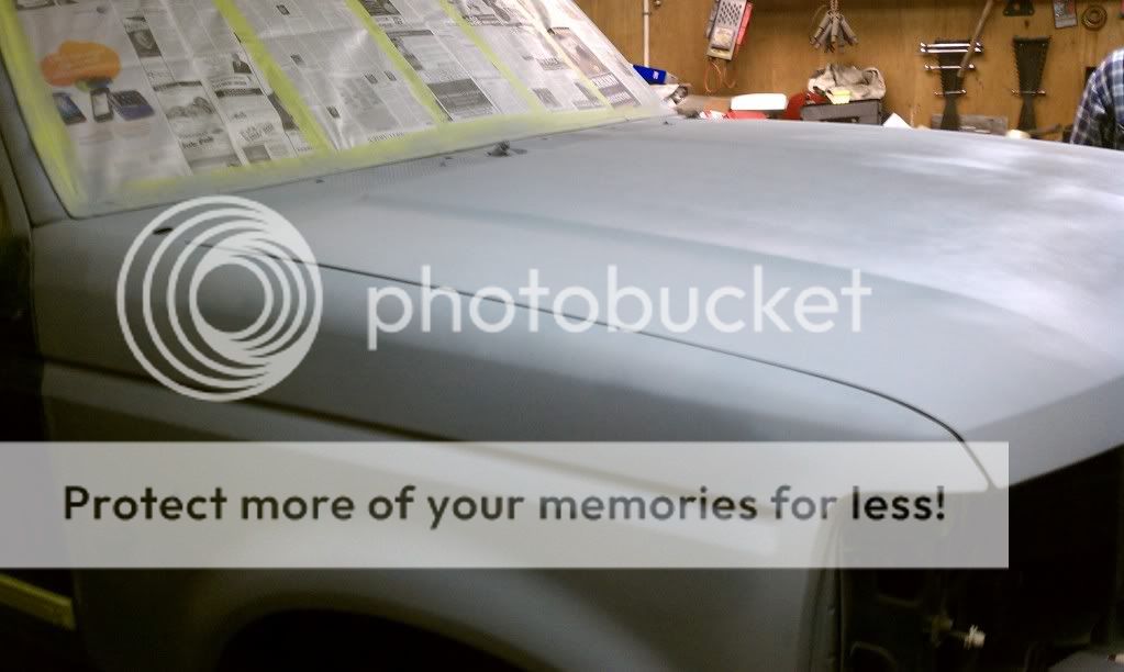

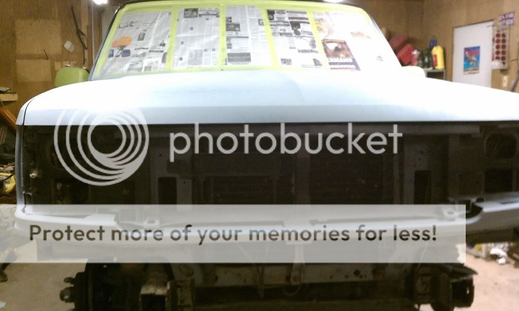

Then went with this

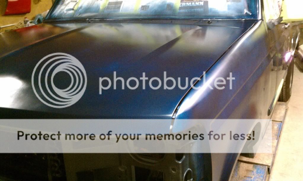

first coat of base
second base coat

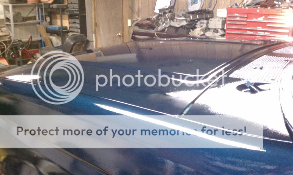

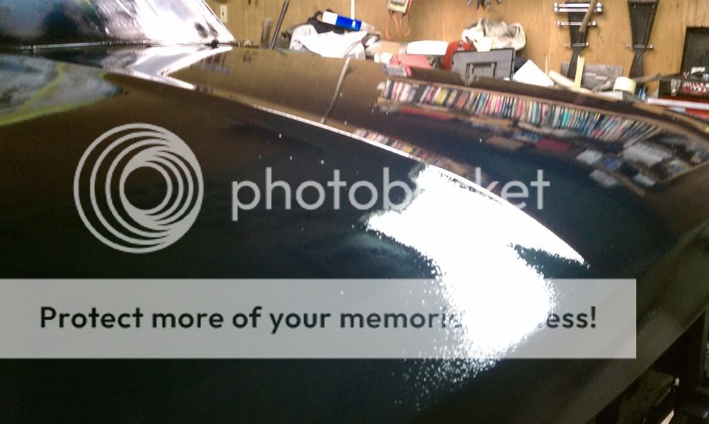

Then 4 coats of clear later
Well thats all the pics i have so far as its raining but i did get the rear end slammed and i mean slammed yesterday.. still got the from to do but hopefully that comes saturday.. still got to wet sand and buff the truck with rubbing compound for it to match but it hink it turned out ok..:icon_bounceblue::icon_welder:
Dark shadow blue? I like it! :icon_surprised::icon_thumby:

And you are going to wet sand an buff right?!
Yes wet sand and buff with compound to blend it better... the ass end is slammed right now went too low so im doing a shackle mount flip to lift it back up 3-4 inches... then i havent done the front yet waiting to get the back fix up so i can match the front.. just waiting on this rain to stopp so i can get in the garage cause its got the 67 4 door impala in it that is getting restored so it cant be out in the rain... but hopefully sat it will get done as i dont have a garage of my own.. i need one bad cause the drive shaft it shoved completely into the trans ==NOT GOOD

And its actually a dark shadow blue Metallic
Looks good hope your better at the wet sanding than i was i had a matte orange peel look going on i left it that way i kinda liked it. But it was my first and it was cold outside.
Yea we had it 110 in the garage while we were painting and i let it bake over night at 90.. ive got a little orange peel going on the top coat of clear but i put 4 coats on it so im not that worried it will get done sometime buffing compound and wet sanding will take care of that and this was my first paint job ever i learned quick smooth strokes back and forth .. i got 4 runs in the top coat of clear so its all good..
