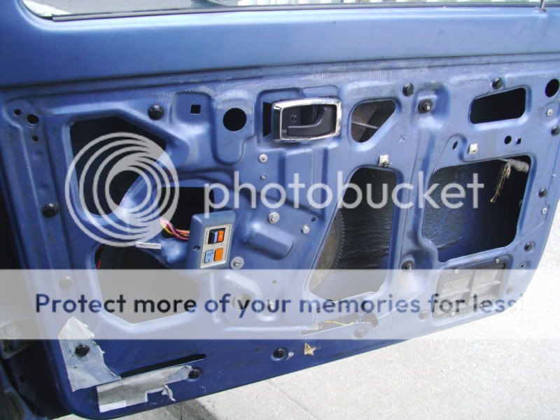

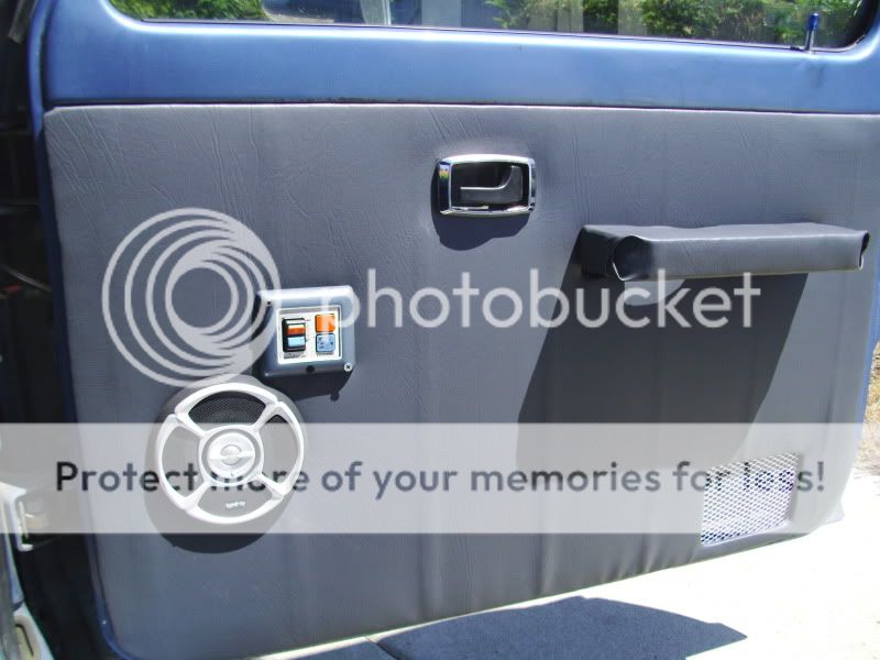

I use to have the old cardboard and vinyl door panels but they got worn out after taking off a couple times, so I decided to make my own. Switched the speakers from the dash to doors also.
BEFORE
AFTER
1st upholstery job

What did you do for backing and to hold it on the door?
I used 1/4" plywood and tap metal screwed it to the door. In between the plywood I used cotton spread the stuff for quilts, and gutter guard for the vent hole(couldn't think of nothing else), oh yeah and cut 2x4 4 the handle.
this was all cheap stuff I mostly had laying around.
Next time i'll have moms stitch the handles so they look cleaner but didn't think of that till i was done. Better then nothin though, everybody was always raggin on my doors.
