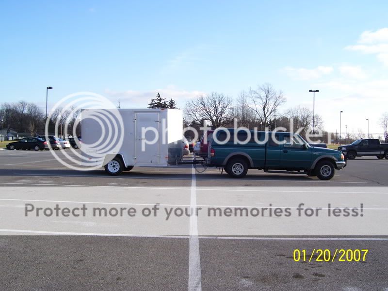

i run steel jeep rims from a '01 wrangler as my winter wheels. had to cut a hole for my front lockouts in the plastic center cap, but no biggie. the 3.0 makes its power higher in the rpm band than the other ranger motors. putting bigger tires on a 3.0 will more than likely need to be re-geared. here is my truck with the winter rims.
