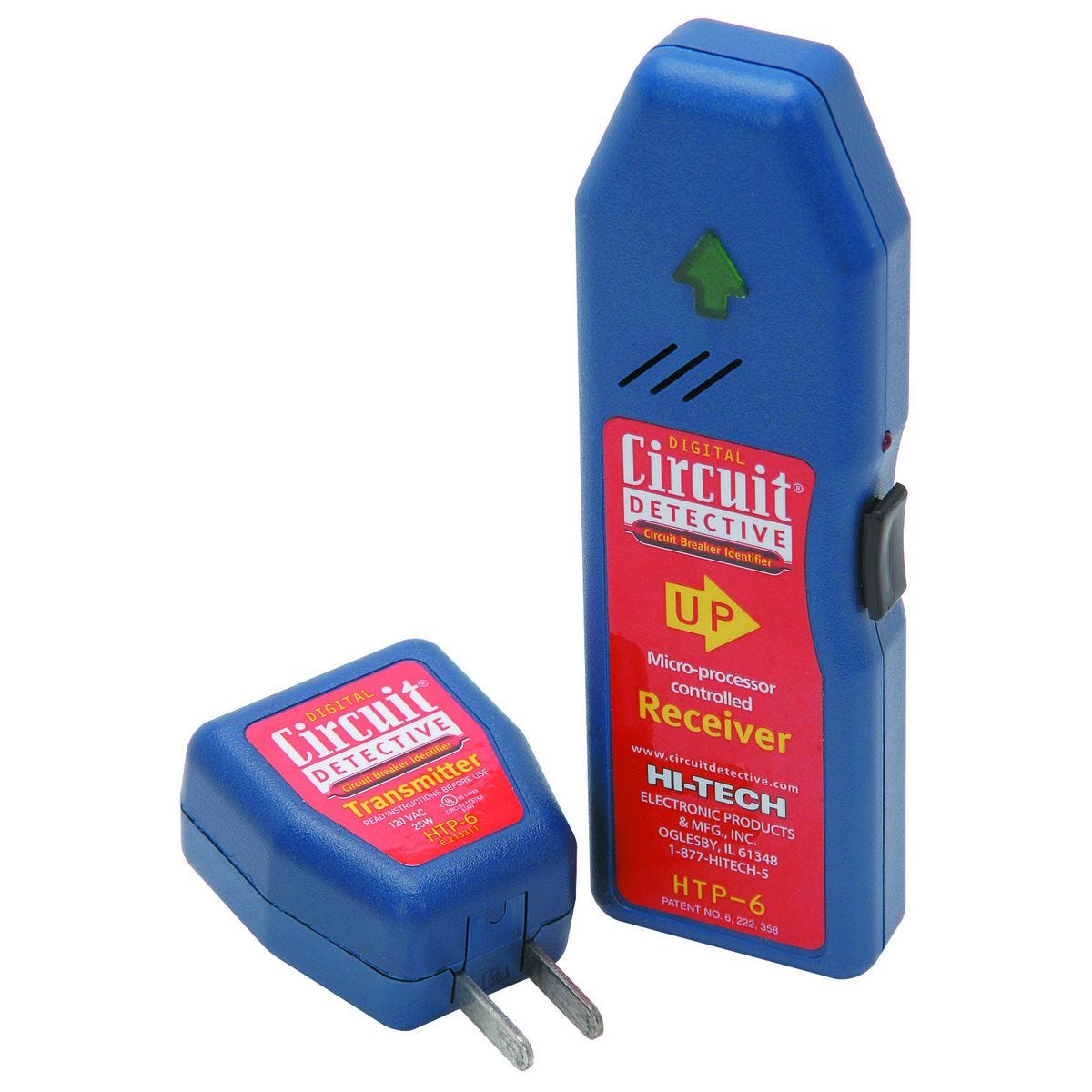

When I was chasing electrical circuits, I picked up one of those wireless testers that you plug into an outlet and the other part, it looks like a fat pen, gets run across the breakers and lights up when the circuits are a match. If I were a more intelligent person, that statement would have been better explained. Someone out there probably knows what tool I'm talking about.
Harbor freight sells one of these cheap. It works very well, I use one at work. One thing to remember, when you reset it, it's on its highest sensitivity and may pick up more than one breaker. But you keep going over all the breakers over and over and it automatically lowers it's sensitivity till it finally picks out the correct breaker. One good thing about the transmitter being powered by the circuit you are looking for, you can then turn the breaker off to see if the beeping stops, to verify that is the correct circuit.
