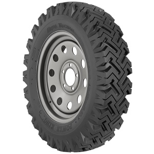

Pretty sure it wont be an issue but a 29in diameter (235/75 equivlent) should be fine on the rear only of a 87 2wd correct?
Im not taking the chance this winter and am getting some 15 inch rims so i can mount some decent tires on the ass of rusty 2.0.
Im thinking about these....IIRC they are very similar to what i ran on rusty #1 bach in the 90s and it was unstoppable in the snow with these and some weight...didnt think they still made them...i think they are the same...or close...but either way...opinions?
What rear end do you have in 2.0? 7.5 open diff?
I see they're only rated to 75mph... not sure they can handle the blistering speeds developed by the 2.9L.
Size would be fine. Not sure I'd want to run bias ply tires but just for the snow months shouldn't be bad.
8 ply tires on a ranger? those look like the old armstrong bias plys from 40 years ago. that’ll ride a bit rough. sure they will fit but hopefully your gears are low enough to handle them, 3.73 or 4.10, im debating on even getting my winter tires out this year, Just dont get the snow here we once did.
Yeah itd only be from pry thanksgiving to middle march or so.
I got 3.45s with a 2.9/5sp, i wouldnt think itd have any trouble with them.

So... those are essentially the exact opposite of a snow tire in every conceivable way. :icon_confused:
Maybe from a modern snow tire. But like i said im pretty sure those are what i had on rusty #1 back in the day...maybe not. All i (vaugely) remember is the tread pattern and i bought them at quality farm and fleet....circa mid 90s.
They pry are to much tire really for a ranger...but i can tell you if they work out good my 97 F250 is getting a set too.

Those Goodyear Wranglers are absolute trash. I've had several sets of them, by FAR the worst tire I've ever had. They dry rot and crack really bad after 4-5 years and something about the tread design makes them follow the little grooves on concrete highways - they pull you all over the place.
I'm fairly certain I had those tires (or at least identical looking ones) on my 78' W350. The only thing I remember about them is them being so damn hard you could run over a penny and tell what year it was. Didn't need any fancy road hazzard warranty with those things. doubt you could put a hole in them with a .30-06 :icon_rofl:
and being bias, youll have the “thump,thump,thump” of flat spots when it’s really cold out for a mile or so.
