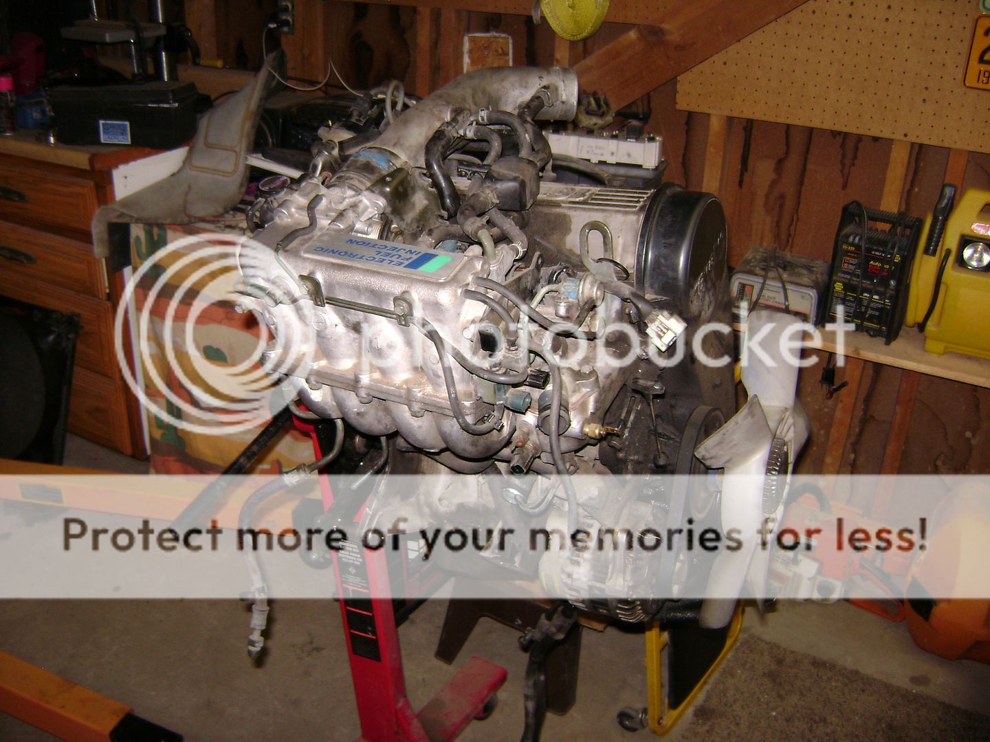

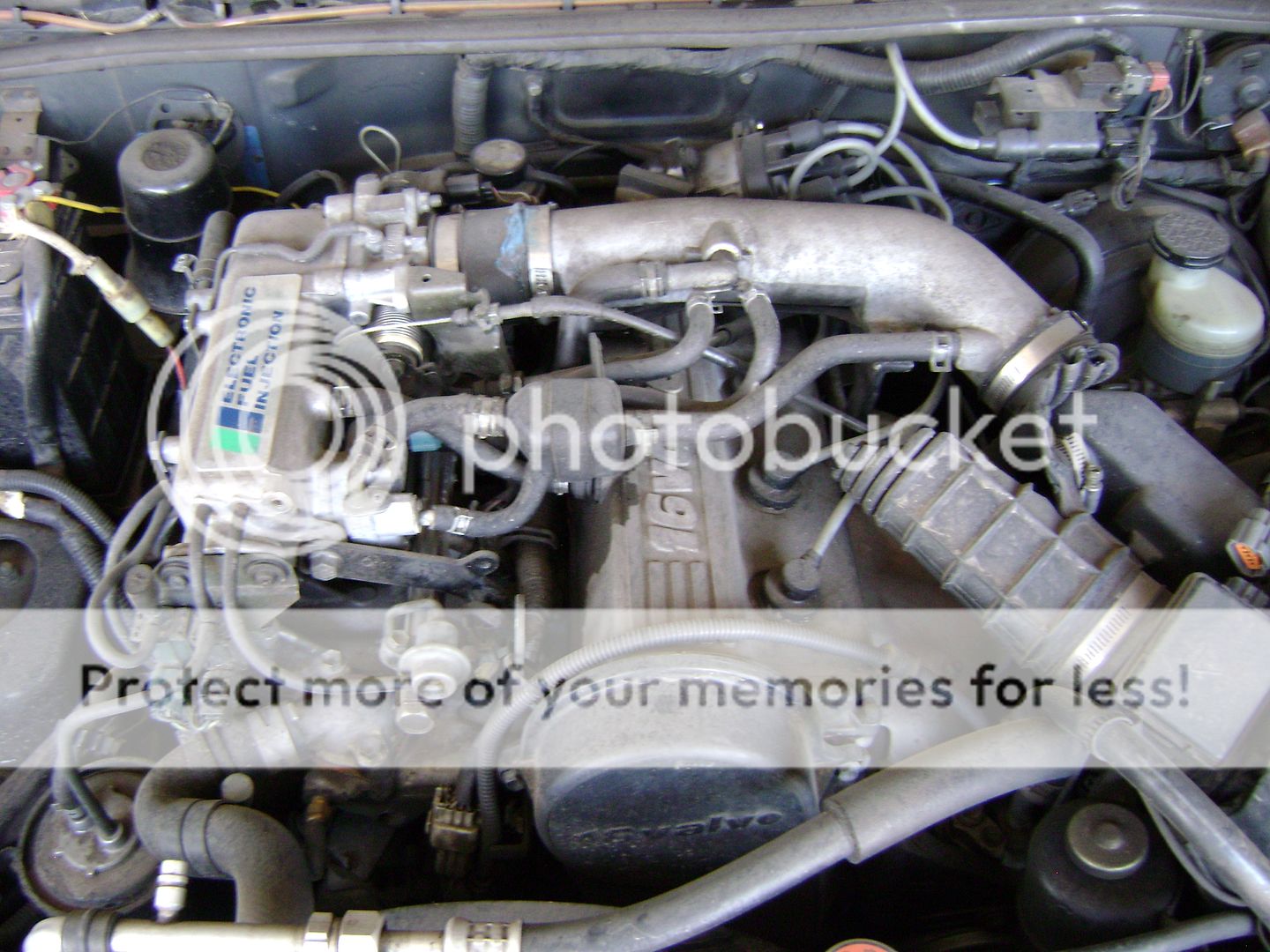

I picked this up a few weeks ago...
Mainly for this....
Its the 1.6 16v. It has the MPFI so it will take a little more to put in my 87 Samurai, but give me a little more than the 1.6 8v. I have been talking to Myron at ZOR, and have a good idea of what its gonna take to do (he will go through the wire harness and make what I need to plug it all together and run correctly). I have the wire harness out, un-taped, and ready to ship out to Myron, but I have to send my gauge cluster as well (both the Samurai and Sidekick)because the Samurai will need a VSS switch put in the speedo (Myron at ZOR again).
I have the 1.6 out of the Sidekick, the PS stuff as well (Im waiting on the rest of my parts to show up) and that will go on my Samurai, as it doesn't have PS. I will do a write up on that install as well.
I wanted to use the 4spd auto out of the Sidekick, but as its computer shift control, and the longer version T-case/transmission, it would take quite a bit to put in. If I can find a GM 3spd auto out of a Tracker then I could use that one, so we will see.
Thats it right now. Like I said the 1.6 is out and on the stand, waiting on a rebuild (the same shop that put my 347 together)
As it progresses I will update the thread. Thanks for looking. BB :icon_welder:

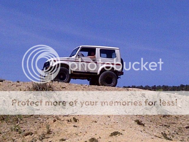

Yes the engine and assorted parts are going into a Samurai...
This one to be exact...

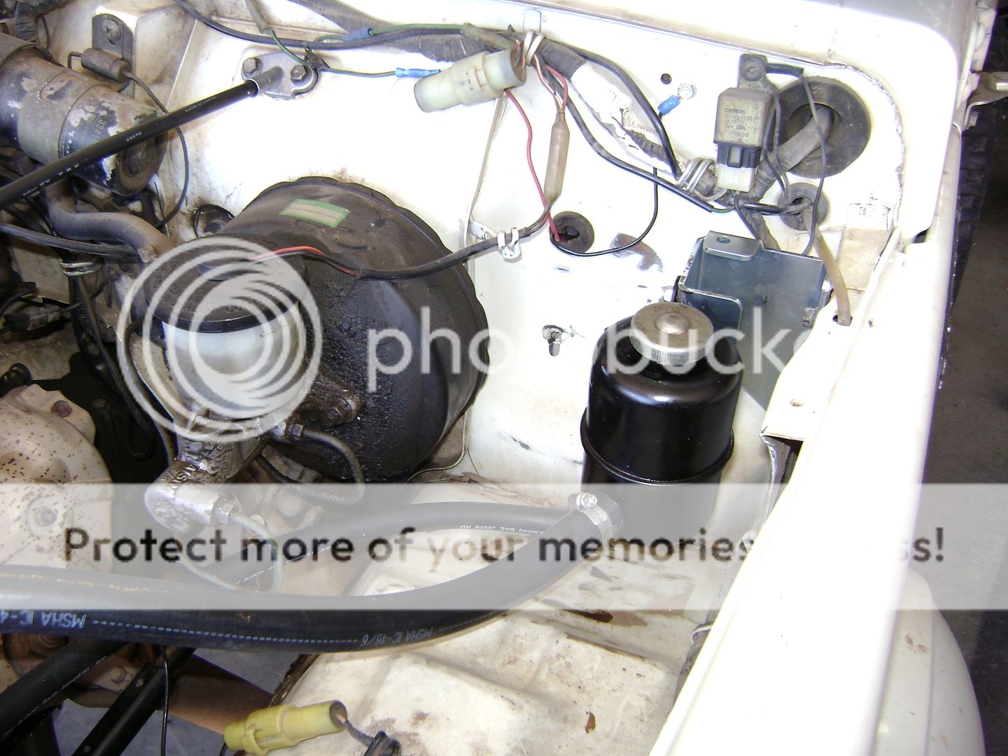

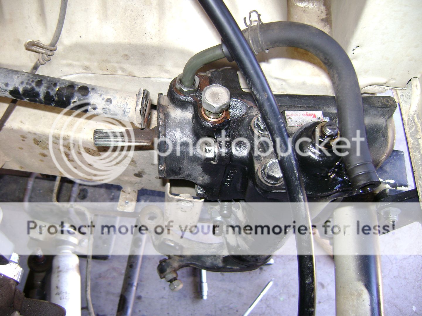

Finally got the Power steering installed and everything lined out. I had to relocate the driver side radiator mount but here are a few pics.

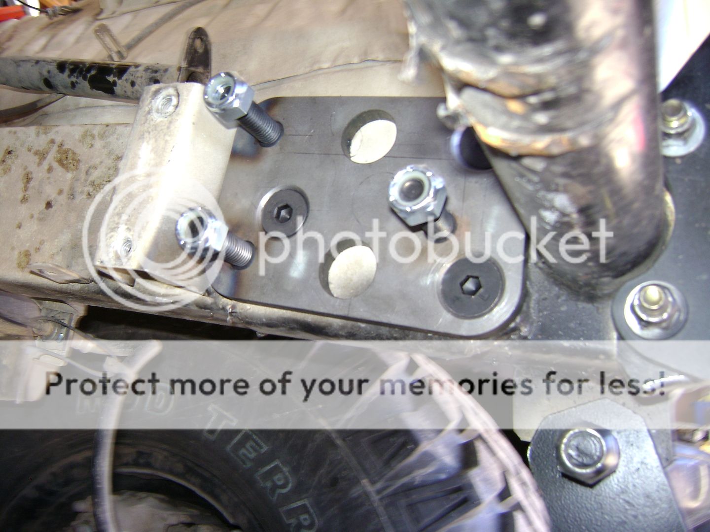

I started with this plate....
The mounting holes for the sidekick are opposite of whats in the Samurai frame. This allows for it to bolt up. It can be done by bolting to lower front of the box to the frame and then drilling and sleeveing the other two out, but I opted for this.

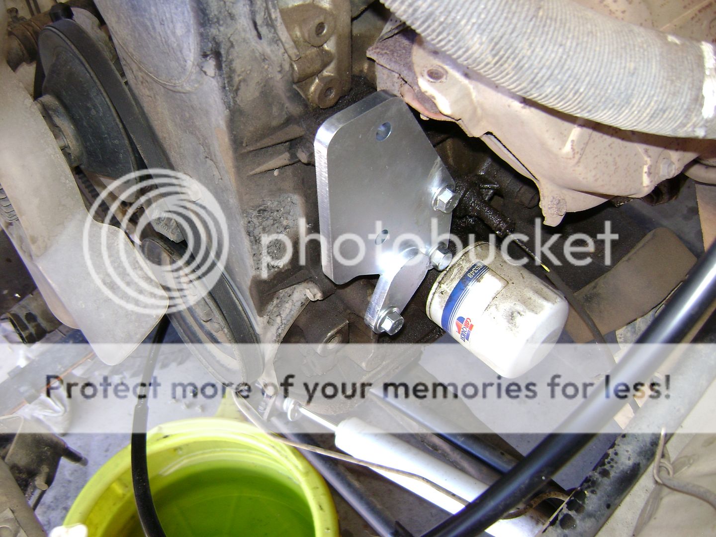

A plate is needed on the block to mount the PS pump to it (this plate will also work on the 1.6)
Heres the box mounted up. You have to shorten the steering shaft. I have a press so it wasn't to hard, but it can be done with a block and a BFH. There is a joint that goes on the end of the steering shaft (to allow it to mount to the box) and gets rid of the stock rag joint.

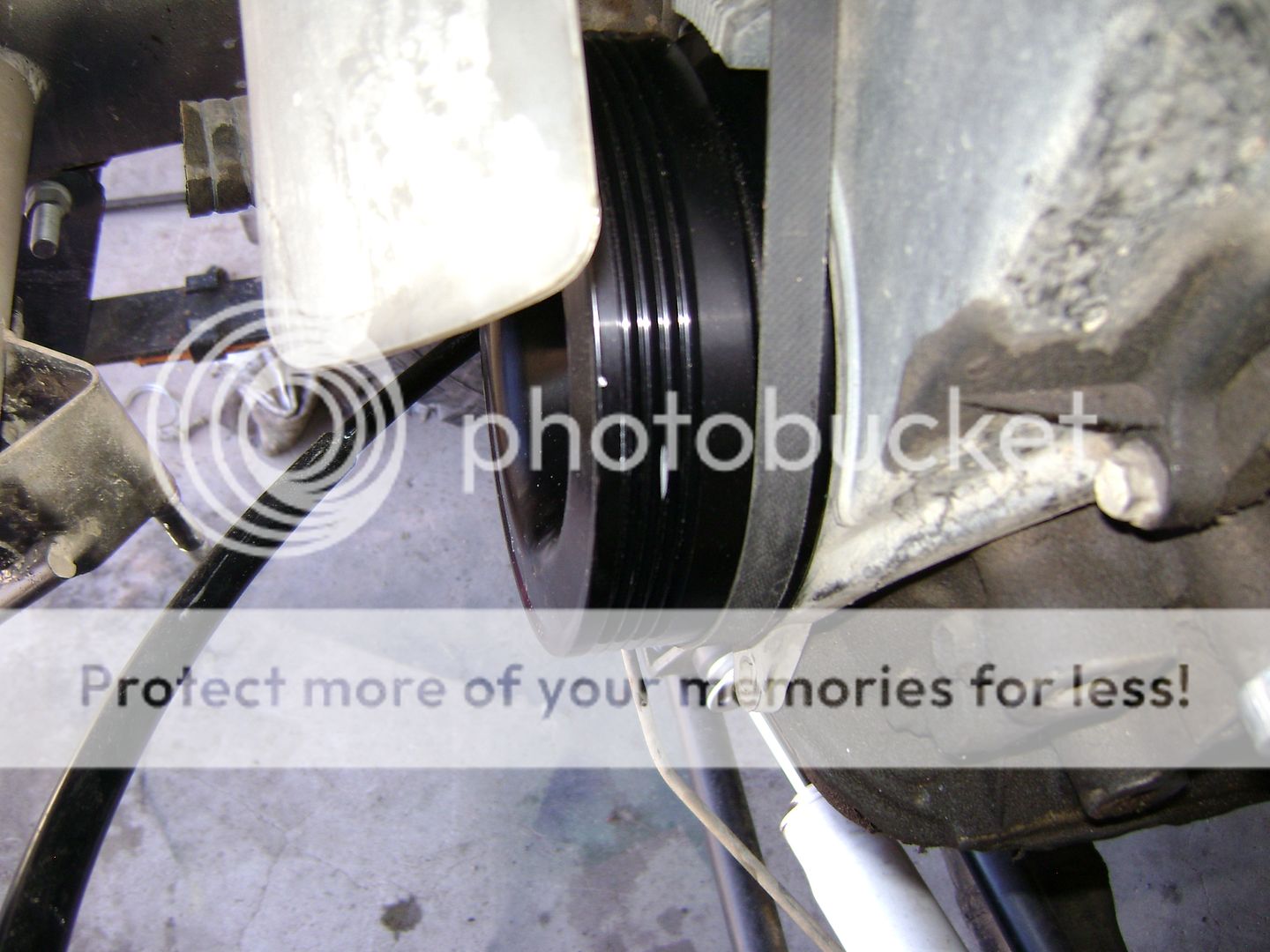

Double belt pulley
Here is where I mounted up my reservoir
