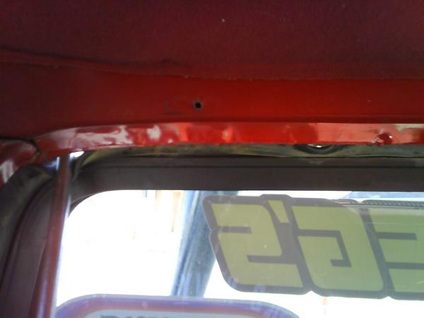

1. First remove inner plastic panels with Phillps screwdriver first above door then above rear window then can take sides off i just tucked sides behind seat so I didn’t need to remove seat belts.
Remove plastic trim
Removed plastic trim
