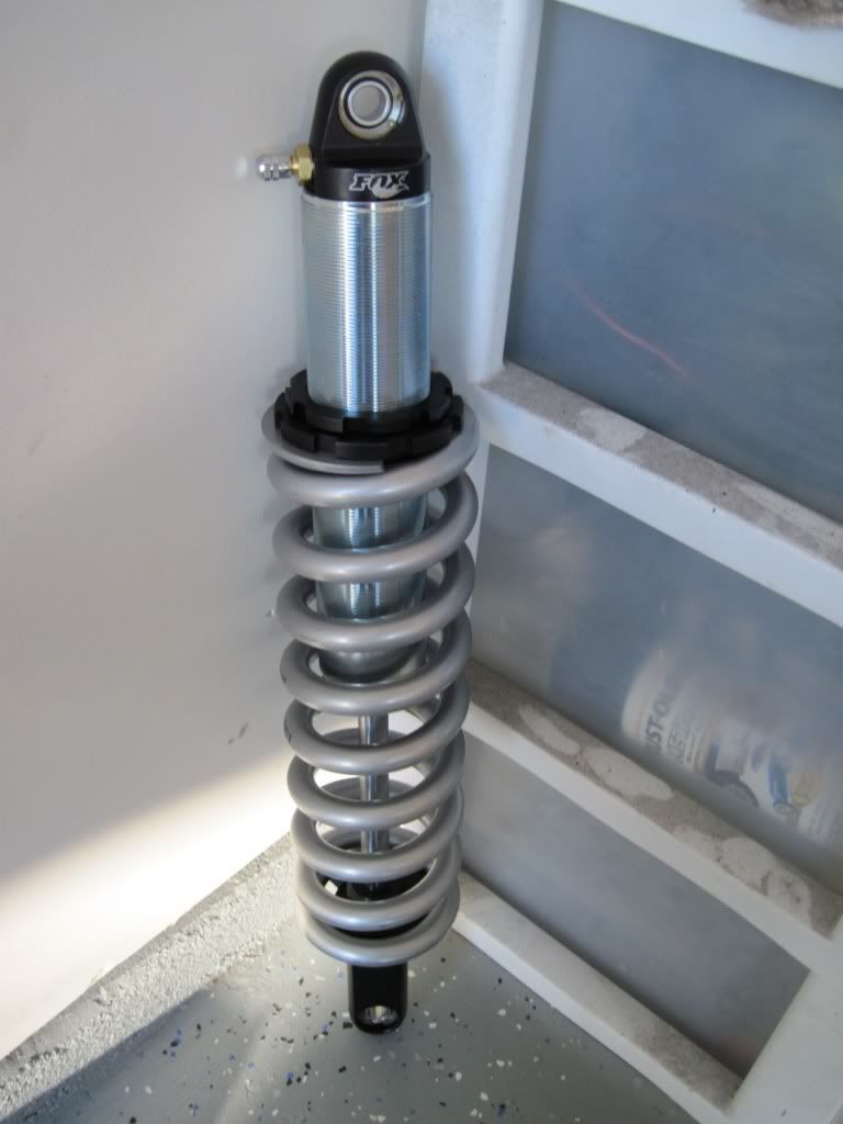

I figured I'd start my thread for this project. Now that I finally have some free time to get started on this. I've had all the parts for over a month now. All I've been able to do is look at them and say..."That sure would look better on my truck!"
Anyway, I started today and got the shock buckets prepped for the gussets to be welded up. I'll get that done tomorrow morning, and then I'm going to tackle getting the coil-over's installed. I'll update this thread and post pictures in this first post that way everyone can see progress. So tomorrow evening expect to see some more pics. I'm posting what I have right now:
Mmmmmmmmmmmm yes......yes!!!!

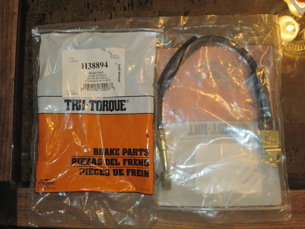

New Brake Lines

hahahah well complete with eibach's they were 491$ shipped.

thanks....the coils are 2.0x6.5 Fox Emulsion with 750lb Eibachs. The brackets are custom made but you can now purchase them from ORW.
