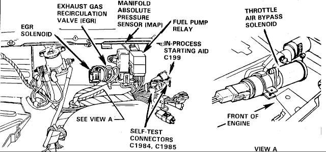

This should be a no brainer for you guys, I'm trying to find the fuel pump relay on my '86 B2 2.9l. I just bought the truck for a song because the previous owner could not start the thing. I immediately noticed that I couldn't hear the fuel pump running. I confirmed that no power is being sent when I put a test light on the inertia switch. Unfortunately I don't have an owners manual, or repair manual yet, buy that is next on my list. Future plans: get it to run!

On the metal panel on the passenger side inner fender.
It may be hidden with a plastic cover between the fender and
the air cleaner box.
I can never remember which relay is which... There are three relays down there.
One black which is for the A/C wide open throttle cutout.
the ones I always confuse are the brown one and the green one.
One is the EEC Power Relay the other is for the fuel pump.
And I simply can't remember which is which...

Green is fuel, brown is ECC.
ECC could be out as that opens the circuit for the fuel pump relay (see wiring diagram on autozone or something.) Could also be a fuse link.

Thanks for the fast advice guys! I had the hood open for five minutes today before I froze. I hope tomorrow morning is not as windy, so I can get in there and check it out.
Psychopete, are you suggesting that if the relay, harness, fuse links etc... all look to be okay, or should I say do not have power going to them, that the problem could be the computer itself and need to be replaced? Is this a common problem for these trucks.

I wouldn't rule it out, but a bad PCM is EXTREMELY uncommon. Even if the PCM isn't getting powered itself (from the brown relay), obvious the PCM is not going to be able to turn on the pumps.
Seriously, get on autozone, look at the repair guides, under chassis electrical, then get to wiring diagrams. You'll see your engine listed. The wiring colors are not right, but the circuits generally are. It's a lot easier when you can "see" how it works.

The problem with my B2 ended up being one relay (pcm) and one bad relay connector/wiring harness (fuel pump). The pcm relay was full of water, so I did not bother checking, I just replaced. I would recommend swapping in a spare relay as a fast way to rule out a bad one. When I removed the fuel pump relay, I noticed the terminals inside the harness were corroded. Rather than testing I replaced the harness connector and reinstalled the relay. The B2 fired right up, even with two year old gas. If that all looks good, I suggest checking for power at the inertia switch, the inertia switch itself,power at the pump and finally check the fuel pump itself. Obviously it would be a better idea to grab a manual, locate the wiring diagram and go to town with a test light. Electrical problems can be additionally frustrating if you try and guess your way through it. Good luck.
