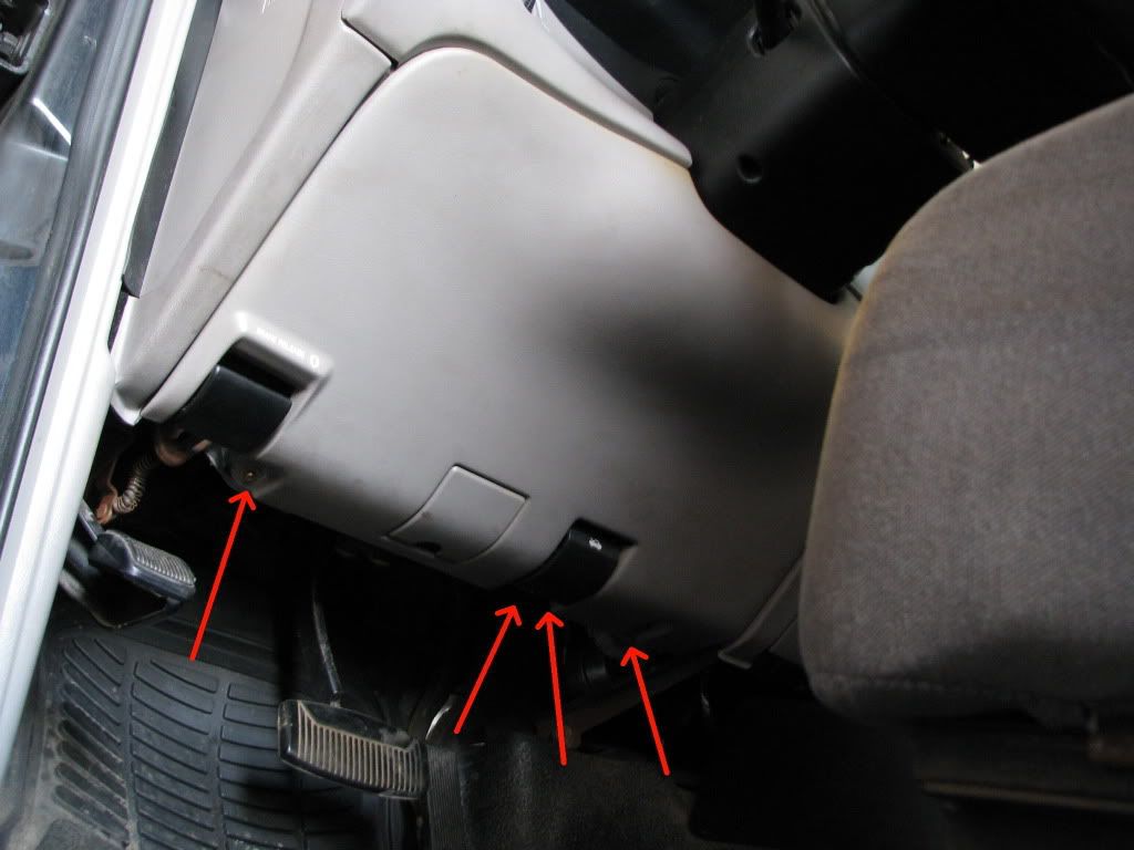

1. Remove the 4 bolts along the bottom side of the panel under the steering column. Two are easily visible, but the other two are hidden under the hood release latch.

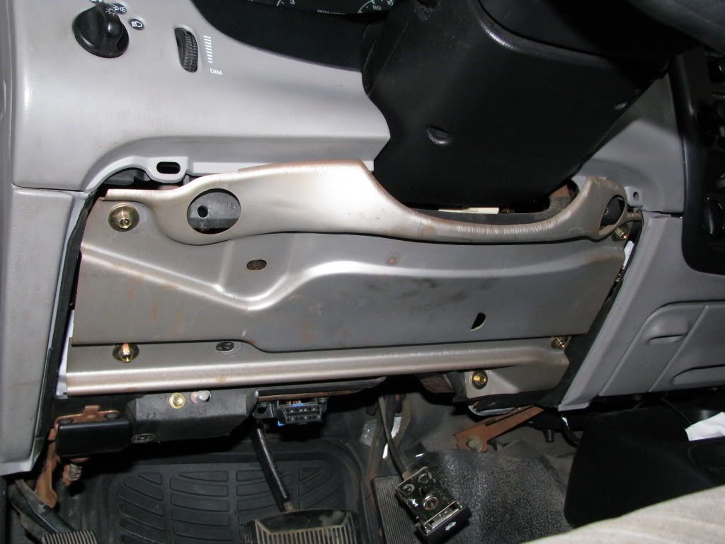

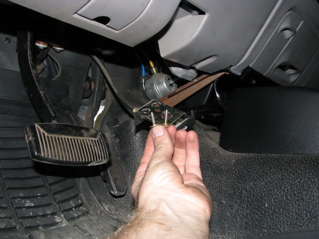

2. Remove the 5 bolts holding the steel plate in place.
Adjust/repair instrument cluster gear indicator (auto trans)

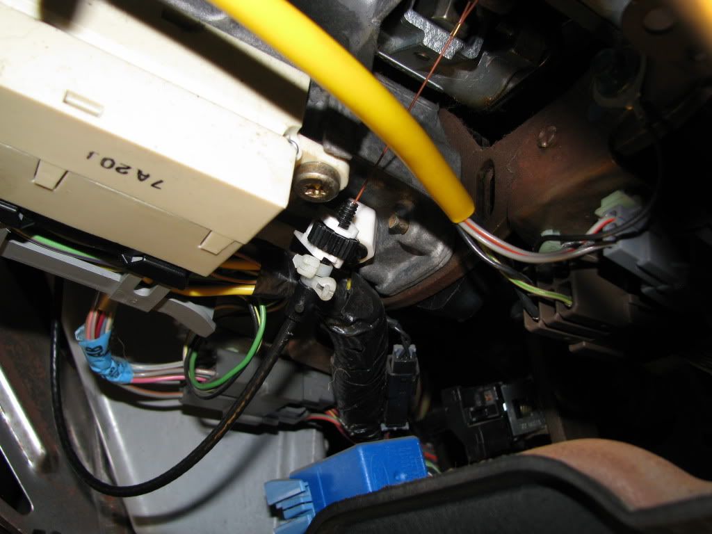

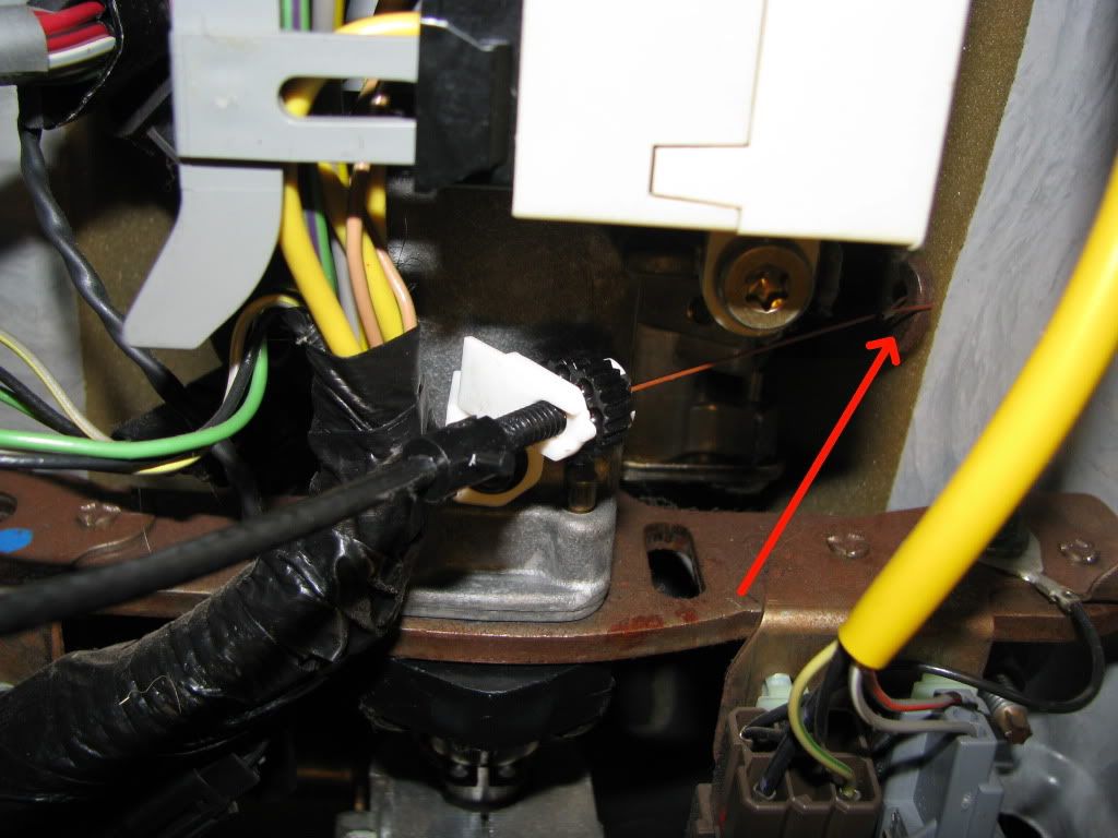

3. Locate the cable for the indicator (thin black housing in pic) and follow it through the adjuster and finally to the inner cable.
4. Check the inner cable to make sure it’s properly secured.

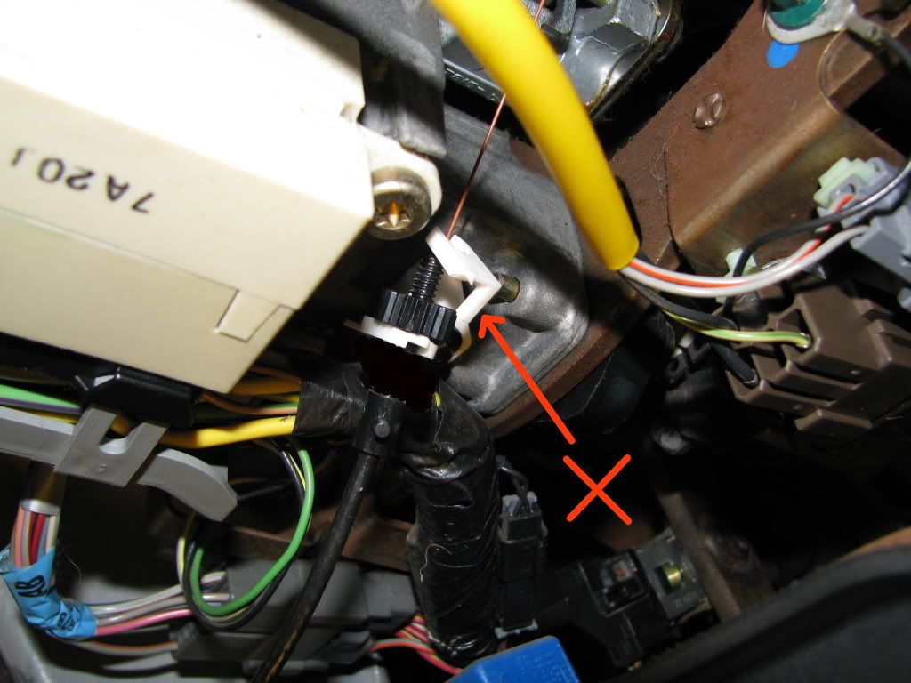

5. If it is properly secured, then check the holder for the adjuster. (mine was broken, as you can see in the second pic) If your’s isn’t broken then simply adjust the cable tension until the indicator reads the proper gear.
6. If the adjuster is broken the same way mine was you can use the following steps to fix it. Since the adjuster won’t keep the cable tension properly you need to fix this, which is incredibly simple (remember the zip tie fix for the throttle cable? ;) ) …..

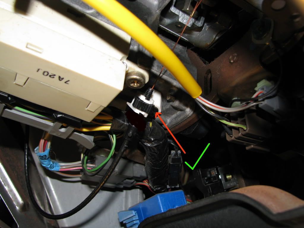

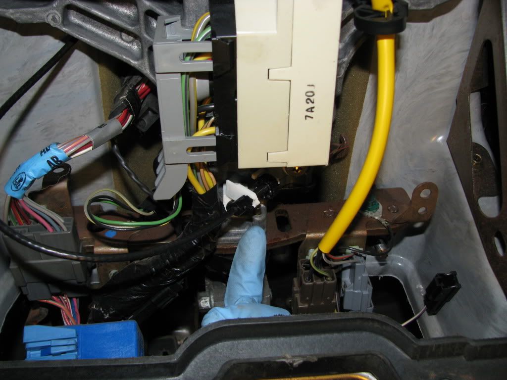

7. Get several zip ties. The amount you will need depends on how wide they are and how much of a “gap” you need to “shrink”. Simply wrap the zip ties around the adjuster barrel (the black plastic part) to achieve the proper reading on the indicator. Be sure to trim the excess tie so it doesn’t get caught between anything and you’re done.
Now instead of Park looking like this …..
….. it should look like this …..
