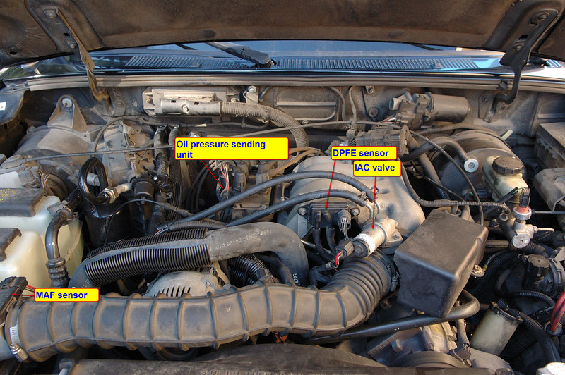

Ok I have a High idle issue that I can not seem to track down. It idles high from first starting and will continue for till I slow to a stop but as soon as I hit the gas it goes back up.
I changed my IAC valve (last one I had cleaned to much and stopped working)
Replaced pcv valve, replaced EGR solioned, replaced catilitc converter, throttle cable (not sure how to test this besides just hitting peddle quickly seeing how it adjusted rpms, also have done by hand at the throttle bottle.)
Checked throttle postion sensor, EGR valve, DPFE (or whatever it is called) Everything is working when testing. I also seem to be getting the correct voltages from the pcm is there a way to test it?
I figure it has to be a vacuum leek but can not find it. What else should I check/ look for.

High Idle
I have a '98 Ranger v6 3.0 4x4. I've had it for about a month. Since I purchased it I have had poor gas milage (13mpg) and a high neutral idle. When moving and engaging the clutch (neutral) the idle hangs around 2100-2200rpm, when the truck is at rest and I rev it up in neutral and release the gas it drops to 700-900 like it should. I have relpaced the AIC and the DPFE sensor, I've tested the EGR solenoid, EGR valve and every vacuum line i can find associated, they work great. All my electrical connections are in pristene shape as well not a bit of corrosion. I've also cleaned the pcv valve.
Please Help! I very much like this truck and bought it for reasonable workload/gas milage. Any suggestions?
