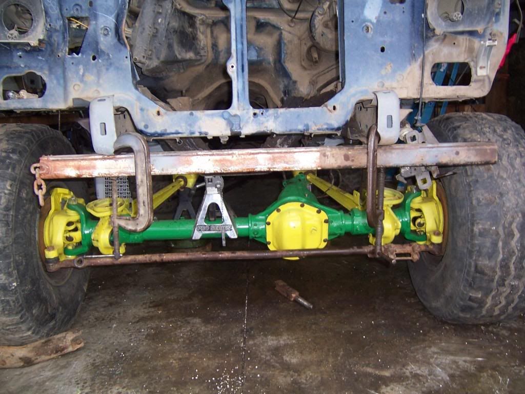

and since it was all tore apart i figured it was a good time to do a solid axle swap.

after getting the full width dana 44 under it i found out the frame was bent on both side infront of the cab. so i cut stock frame rails off and built my own out of 2"x5" .188 wall tube.
i used 4" bronco graveyard superflex coils and stock f-150 coil buckets

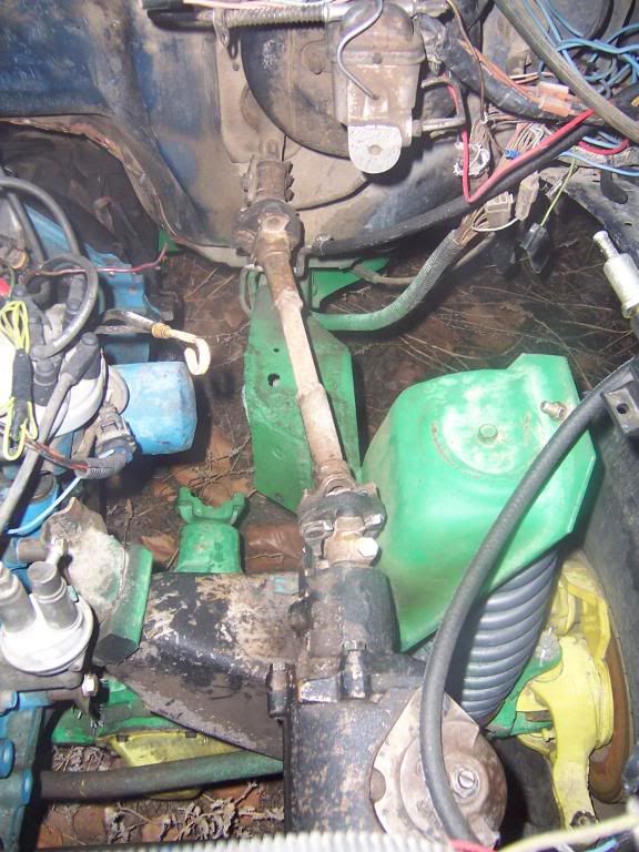

? how did you shoe horn the straight six in that truck? Is the ingine compartment long enough for that or did you have to lenghten the nose?
the 300 fit with just a little firewall beating. the radiator is goin to be mounted to the roll bar in the bed. the whole thing is goin to be JD green and yellow but i just havnt had the time to paint it yet
when i made the new front frame rails i made them to be the same width as a 79 f-150 for ease of mounting the radius arms, motor mounts, and steering box

hell yea! thats a sweat rig. i'm really digging the 300 I6. got any more pics of the engine bay?
