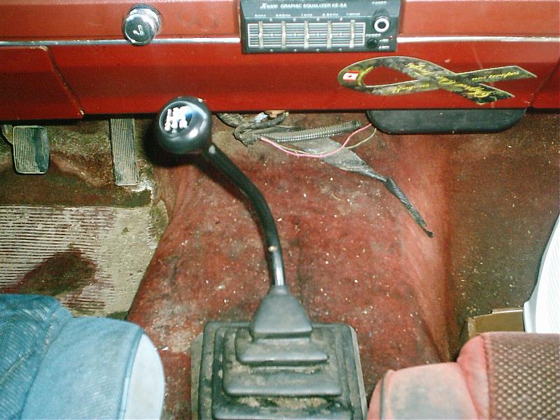

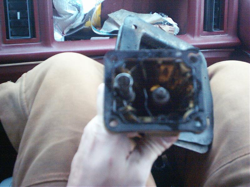

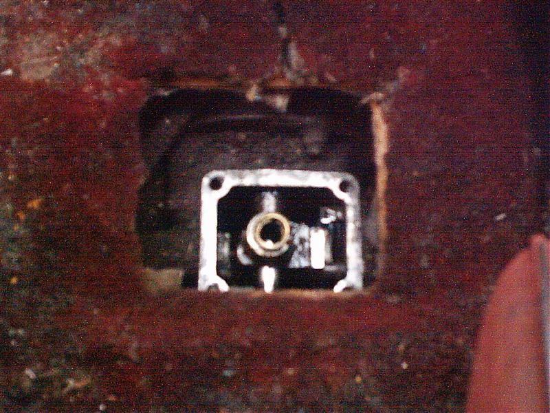

Update the install
Pictures of install
first image is the old Shift lever
second is the boot loosened
third is the place on the transmission that shift lever goes, note the Brass spring and transmission is in neutral
fourth image is the shift lever transmission end
I had to remove the shifter knob to get the boot off. Knob was glued on so this had to have been done before. The new Shift lever came with 4 new bolts. It was just a matter of putting everything back together with the new parts. Then installing the old boot and shifter knob. I did not find this job hard at all.

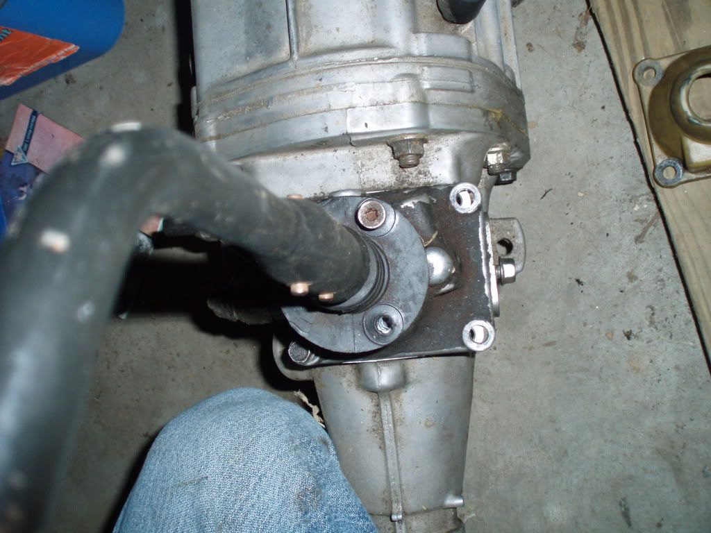

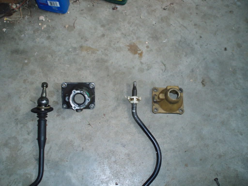

I was going to say (a bit late, but oh well) that you could find a TK4 speed and use it's shifter mechanism.
You'll have to elongate two of the holes, but other than that it's a hell of a better shifter. It's made out of solid machined metal instead of having a plastic ball glued on for a pivot.

Today I had located my Tk4 shifter that I was going to take pictures of post up here to show the quality differences between it and the TK5 shifter.

Interested in seeing difference between the TK shifters. IF the TK4 doesn't have the stupid plastic bushing holding the shifter in the mounting cradle I'll go get one. I know there is at least one in the yard I frequent.

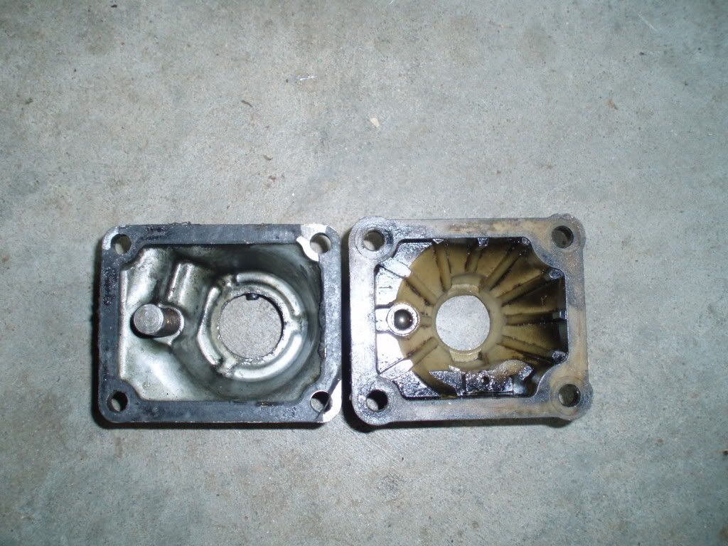

Tk5 shifter tower
Tk4 shifter tower
All you would need to do is elongate two of the holes that don't fully line up in the second picture, and (I think) shorten the spring so that it lets it go into reverse. When I bolted it on to test it, it worked fine except that I couldn't get it into reverse... My dad's already done the swap, but I forgot to pick his brain on what all he modified to get it to work. I'll post that up later.
Aw that one has those stupid pins through the shifter handle with the rubber/plastic bushings that wear out and make the shifter flap around. I might grab one anyway and see if I can "fix" the little bushings with some large roll pins or something.
Thanks for the photos.
I don't think that you'll have too big of a problem with that shifter and the bushings wearing out...
