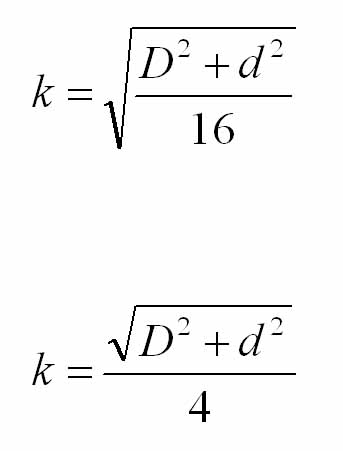

You give the formula for k as k = sqrt(I/A). I've also seen Radius of Gyration for the tubing listed as k = sqrt(D^2 + d^2)/4. When I do both I get different results, so which formula is correct for the tubing. Also, you didn't mention the formula for A (Area of Section). For tubing I have A = pi(D^2 - d^2)/4 or A = 0.7854(D^2 - d^2). Is that correct?

I took my equation for k and plugged in the equations for I and A. I used I = (pi/64)*(Do^4-Di^4) and A = (pi/4)(D^2-d^2) After doing the algebra, I came up with the equation you listed k = sqrt(D^2 + d^2)/4. I put them into excel and got the same answer for k for both equations. Your equation for Area is correct.

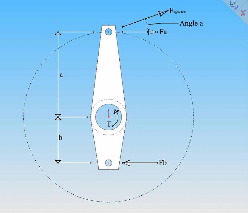

As for the loads applied to the links when torque is transmitted to the axle. Those links are going to have to (at a bare minimum) be able to resist the torque at the wheel. I drew a quick four link axle bracket in the image below. Use your crawl ratio to determine engine torque at the wheel.
Any engineers or engineering students here?
Fa = T/(a+b)
Fb = T/(a+b)
Those equations above come from a simple supported beam (the bracket) with a moment load (axle torque) applied somewhere between the supports (the links)
Keep in mind that this assumes that the link is tangential to the torque moment. Since this is an off road truck, the axle is surely going to be below the frame mounts for the links. This means that for the same torque moment, the force on the link will change as the suspension cycles from droop to compression.
If the link is at an angle away from tangential, then the force in the link will be the tangential force divided by the cosine of the angle. In the case of my drawing, the force on the upper link is:
Fupperlink = Fa/cos(Angle a)
The same procedure can be applied to the lower link.
Krug,
Just to make sure we're on the same page:
This is:
k = SUM(SQRT((D^2)+(d^2))/4)
The sqrt of (D^2+d^2) and then the sum of that sqrt is divided by 4.
