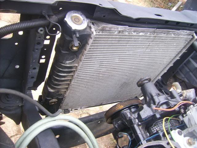

just finishing my v8 swap and have rad mounted . its set back and i had to cut a good piece out to fit rad . i boxed it back in ,and is sturdy enough i need some deferent ideas on finishing it off visually. i would like to incorporate a fan guard as iam running mechanical fan

i put plan c into action its is what you have done here bigblockranger .i cut and lowered the bottom also ordered aluminum rad for it . its so post to fit in the stock hole ill wait till it arrives before finishing it off sick of changing. at one time i had it boxed back in but it looked hack so do the install and worrier about the final touches after.keep the the ideas coming though shit always changing thanx guys

this is my set up built a rod to get around tranny cooler to hold valance. moved rad forward and down. punched 6 holes in bottom of rad support ,2inchs of rad would never have seen otherwise.thats my old rad using for mock up 3 core aluminum on its way.
