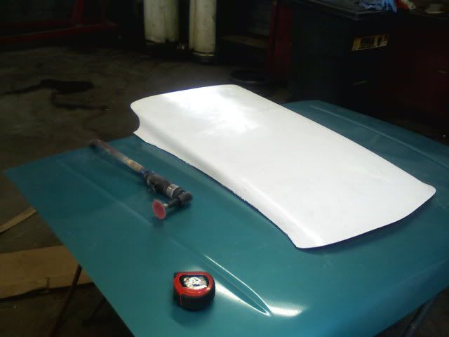

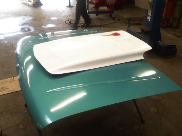

Thanks to a fellow TRS member, I found a straight hood the same ugly color as my truck, and I also got a 3" cowl scoop from him. I plan to use epoxy, rivets, and fiberglass to attach the scoop to the hood. It will be painted between the lines in the hood with spray-on bed liner, and the outter edges left in Calypso Green.
Flat scoop rounded Hood

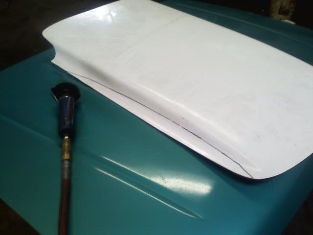

I traced the curve of the hood onto a piece of cardboard the traced that onto the scoop
Ready to start ruining things
Lays down a little better now
Cleaned up my cuts for a little better fit
Ruined the paint and ready to attach it

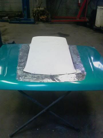

Got it attached to the hood, used 30min epoxy and pop rivets. I got all the supplies to lay the glass, but I'm waiting the 24hrs for the epoxy to completely cure.

Here is the pics from todays work.
I positioned the scoop, then drilled the holes for the rivets.
I then flipped the scoop over, and applied 30min epoxy to the hood and scoop.
I then lined the scoop back up with the holes, pressed it together nice and tight, and put the rivets in.
Tomarrow, I will lay a thin coat of primer over the glued areas, because I've been told the resin will react with the epoxy. Then I will start lying down the fiberglass.
I looks crooked in the pic, but it's not
Front edge glued and riveted
Pass rear corner glued and riveted
