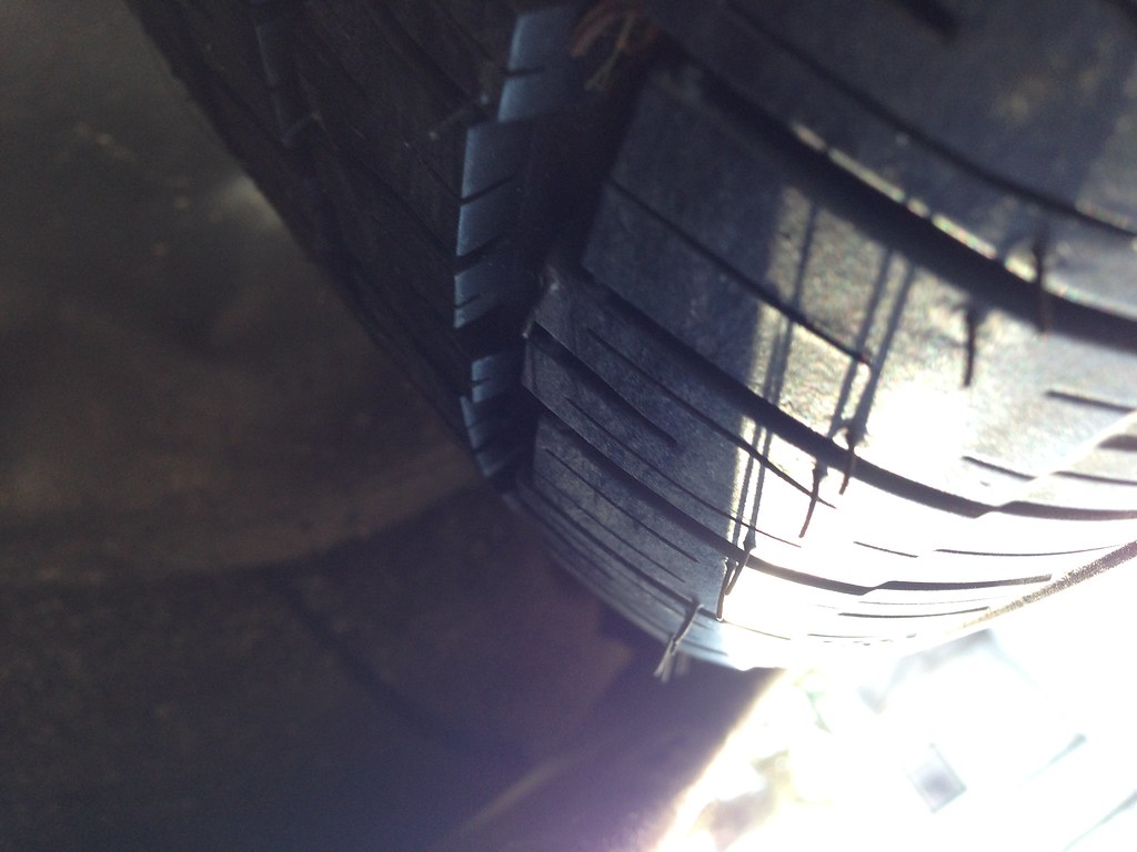

Also running a 295/50/15 tire. It will not fit because of the leaf spring, wheelwell is good still have a couple of inches clearance. I moved my springs to under the frame and flipped the axle also move spring perches, shock mounts inward. Made brackets for the springs. Still has the same ride height as before. Wheels do not stick out

I was wrong about the fitment. looks like it will fit but be very close. Wheel combo I have does not stick out, right at the wheel lip so being lowered you would hit the outer edge. Straight edge on the original spring perch shows how close it can be, maybe 1/2". Pics for reference.

Thanks for the pics they really bring it to form that's prity close, there probably even close when on the ground. compared the two rims and the ones I was looking at have 1/4 inch less back spacing witch would make the inner fender rubbing worse. probibly just going to order the 8 inch wide's to be safe don't want to start pulling my fenders. That fab work on the hangers looks awesome and you're engine bay looks way cleaner then mine.
