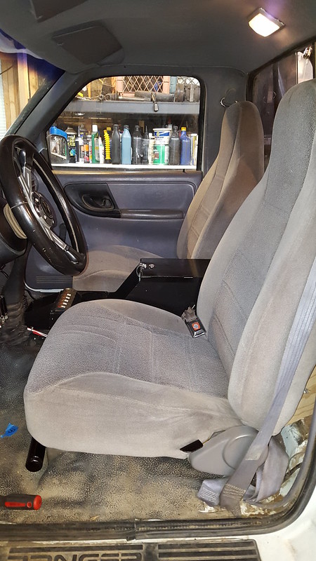

1. What year ranger and cab configuration?
1993 Ranger Standard Cab​
2. What were the original seats your ranger came with?
60/40 bench​
3. What did your swap seats come out of?
95-01 ford explorer​
4. Were you able to use your original seat slider tracks?
Yes​
5. Were modifications if any were needed to bolt the seats into your ranger?
Two holes in the bottom of each seat needed a tap ran thru them. This allowed the factory ranger tracks to bolt to the bottom of the seat. I also trimmed the plastic cover piece on the side of the seats to cover only the recline mechanism. The ranger tracks do not have a front mount for the plastic to clip to so it would have fallen off anyway if not cut back.​
6. Any other special information you may find relevant to the swap others should know.
No​
7. Post a picture of the new seats installed in your truck.
20151201_164247 by Matthew Dresselhaus, on Flickr

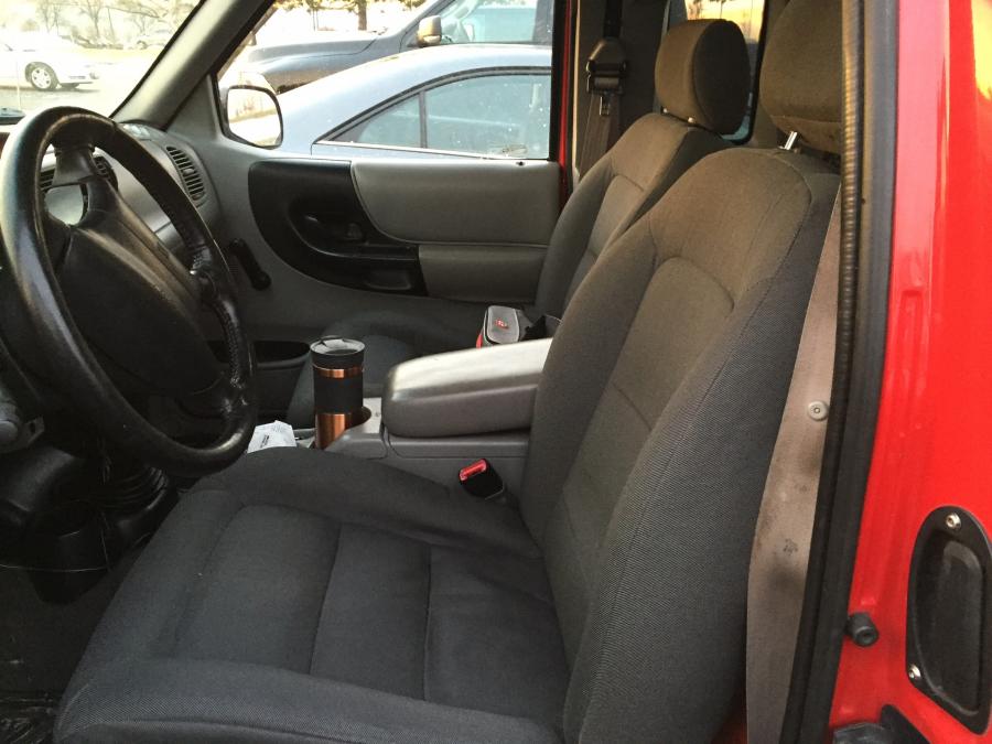

1995, Regular cab
40/60 with armrest
2000, Regular cab, 40/60 with armrest
I didn't... and the slider tracks AFAIK are integrated to the tilt assembly, which is different. So NO.
The newer seats have a very, very similar floor bolt pattern. However, I did need to swap to fresh bolts with fender washers and file out a couple of the mount holes (otherwise the tracks would bind).
Also, I removed the seat belt receptacles mounted to the seat sides since my factory receptacles are floor mounted. I also cut off the (broken) plastic sleeve from the driver's side receptacle belt as the twist at the base didn't agree with the hole in the driver's seat. I zip tied the driver's buckle to the arm rest support to keep it from falling in the hole.
The seats ride about 1-2" higher and the seat backs have a greater range of latching (tilt) positions, especially in the forward direction. They ride well too.
I also zip tied the two passenger seat belt receptacles together, again to prevent the center one from falling. The one downside to these seats is that they do not tolerate falling seat belt receptacles well
Here are some from another thread:
attachment.php
attachment.php
Zip tie fix:
attachment.php
__________________

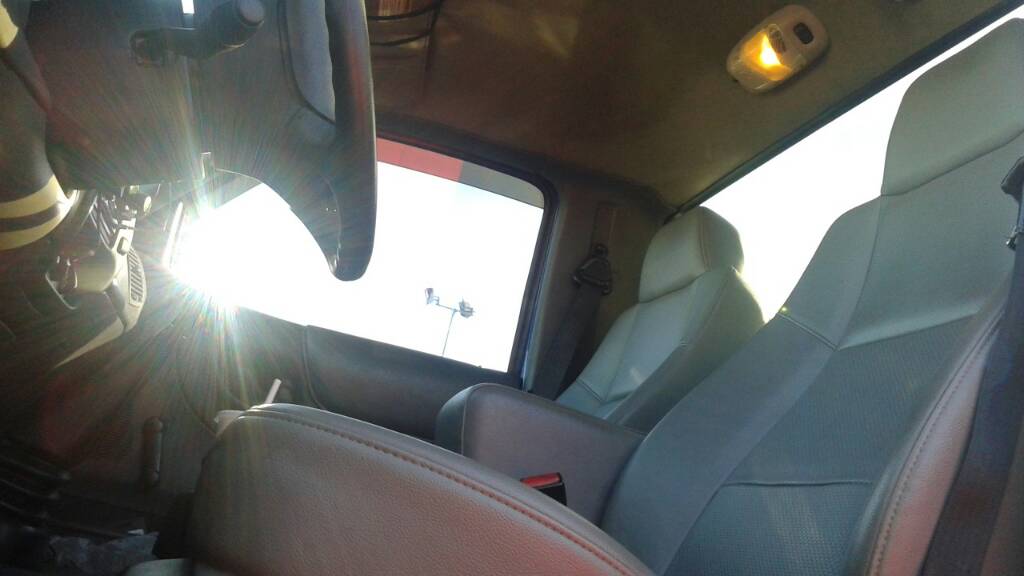

Truck 1: 2003 Ranger Edge single cab
Truck 2: 2002 Ranger XLT 2 door ext. cab
Both: 60/40s
Truck 1: a 2006 XL reg cab Ranger
Truck 2: a 2000 XLT 2 door Ranger
Both trucks: No
truck 1: belt buckles would not work with the belts. To swap pretensioners I needed a new type of nut to go on to the threaded pole that held the 06 ones on as the old but was specially made.
Truck 2: belts again, the buckles actually worked with the belts but the passanger side did not have a plug for the airbag so the airbag was disabled until we pluged in the belt from the 02
Truck 1: 04+ seats are a pan with foam pretty much and are less comfortable than the old seats to some. Also, the back is thicker and in a reg cab you can not slide as far back. I keep them only because of the memories I had with them in my first truck but if I was looking for new seats would probably go with mustangs.
Truck 2: with all the springs in the older than 04 seats, a few weeks after the swap some gave out and made the seat uncomfortable. Beware as they are well over 10 years old.
Truck 1:
Truck 2:

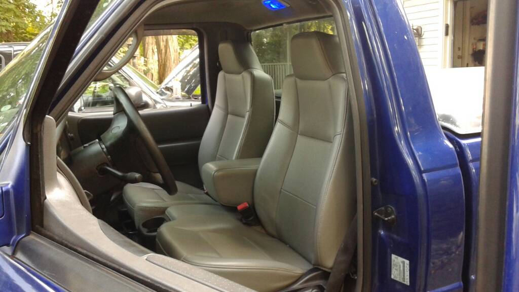

99 extended cab
40/40 buckets
01 explorer sport
Yes, but I used the explorer tracks because of the seatbelts
Holes in the explorer rails needed to be opened up a bit.

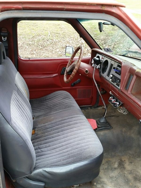

1984 Ranger, standard cab
Standard bench
1991 Chevrolet S-10
No
Front bolt holes needed drilled. Back holes bolted into factory holes.
Used washers to shim the front of the seat up. Felt like sitting downhill.
