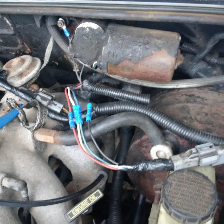

So...I finally got around to wiring the wiper motor...anyone familiar with this will know that the 88 had 4 wires under the hood to the wiper motor and two to the windshield washer pump.
The 1996 Ranger (3rd gens 93-97) has six wires to the wiper motor and 2 to the windshield washer pump...
I dragged my feet as much as I could because I could not remove the 96 wiper motor and fit it into the 88 cab...it might work with a bit of massaging of linkages and all that...but anyone who has ever worked in that cowl space knows it's a contortionists job...not anyone with a 14" or longer forearm...
So...I finally got hold of the wiring diagrams for both years and...glory be! They are almost the same...except the two extra wires on the 3rd gens are grounds.
So...without having any clue as to what ground went into the red/white/blue/black cluster from the 88 I simply grabbed one and connected it up and put the other two to body ground...
It was only a few 30 amp fuses (at 65¢ a pop) before I realized that I had to go buy more fuses and disconnect that black wire...so I did...and tried one of the other two that were grounded...
:yahoo:
Now the wipers work...

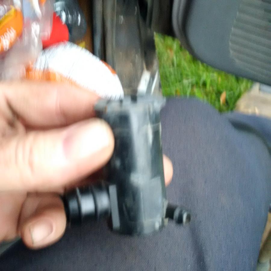

A side note...those washer pumps...they can be removed and swapped into any number of washer fluid containers...the ones with the -| type connectors that is...the older 88 and previous bottles I could not figure out how to remove the pump without destroying the container...

Some pictures for anyone interested...the wiring pic shows the two clips joined into the 88 motor...it's not finished exactly as I need to wrap and cover the wire connections...left it open to show wire connections.

Sorry to bring back an old thread, but I'm hoping to replace my washer pump soon (it doesn't work, doesn't squirt my windshield). Searching for relevant threads I found this one.
Do I read correctly that the pump can be removed from the reservoir, so that I only have to replace the pump? How does it come out without destroying the reservoir?
Thanks!
It just kinda snaps in there. Mine just has 2 screws holding the whole reservoir into the fender. Just pull the whole reservoir and it will be easy to work on. Once you unplug the wires, you can get a screw driver in and carefully pry the pump out. The pump inlet snaps into a grommet in the tank.
You should be able to get one pretty cheap at the junk yard.
Eric B
Yes, like Eric said...just pops in. The early pumps had a two prong plug with the prongs connecting in parallel like any electrical wall plug and socket. The newer pumps have the connector shaped like indicated in the original post -| so all you need to do to get those to work is to splice in the connector for the pump.
If you find one in the junkyard that has a different plug just cut the plug wire and you can splice in any two wire connector to run any plug. Including bottles from other makes as long as they take the same voltage and use two wires.
