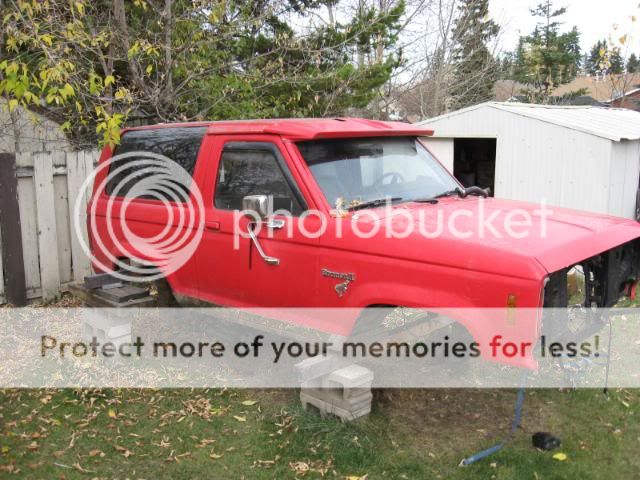

Since I had to sell my rust bucket b-2 and am having withdrawals, I've decided to do another. This one the body is almost mint, and comes with 4.10's, a 4" suspension and a 6" body lift. This '85 b-2 was given to me by a neighbor in thanks for helping store stuff when he was going thru a divorce. Good deeds sometimes pay :icon_surprised:
I also have a rolled '91 explorer with a good running 4.0/5-spd that I paid $500 for.
These two trucks I've been dragging around for several years waiting for the right time....and it's now.....ish. I have no garage and limited use of a concrete pad where I have my stuff stored. My plan is to do a quickish motor/trans/t-case swap and then finish the detail work in my gravel driveway. Not the most ideal conditions with winter nearly here.

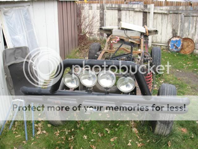

I decided that since I removed the motor/trans/tc as a unit, I am going to put it in as one. So I removed the rad support.

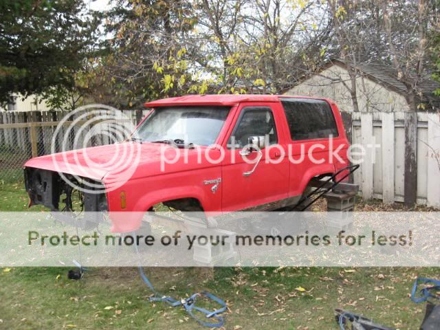

Nope, the body isn't off any more and I don't have facility to do so. Too bad as everything is unbolted. Also the body is just resting on the frame right now. There is a custom gas tank that needs the lift for clearance reasons so I will be re-installing it, albeit with custom lift "pucks" trying to keep the body lift as low as possible. I'd rather there wasn't any lift but oh well.
