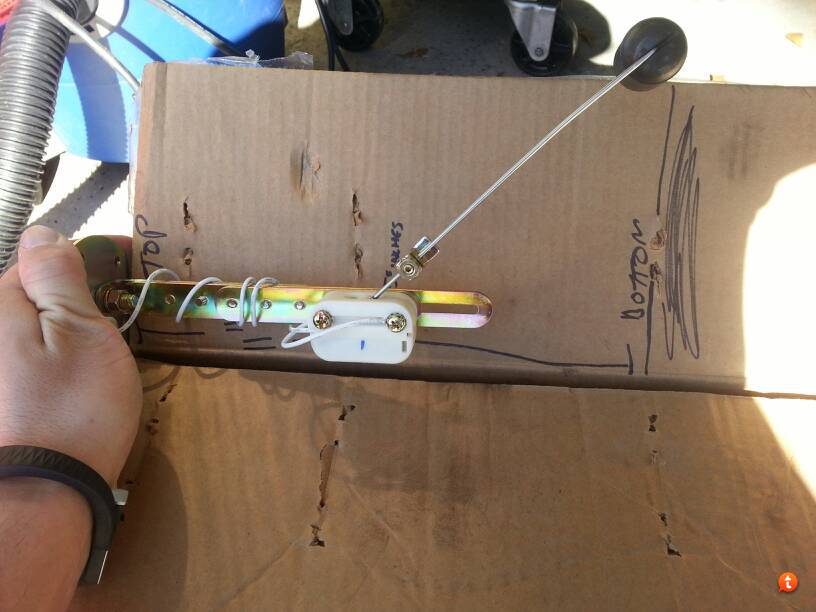

Measure the depth and if needed draw a template. My tank was 11 inches so I put my sender length at 5.5. Then I cut the float rod and installed it on the sender.
