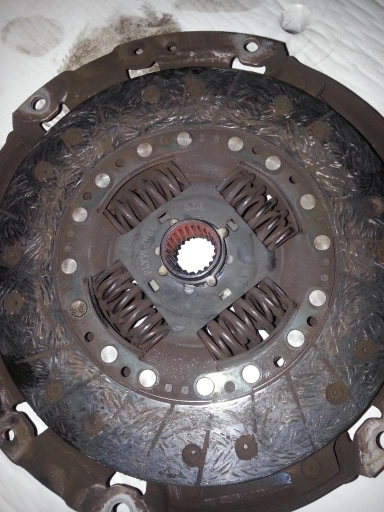

So i dropped the transmission today took about 5hrs 2 of those figuring out how to get the top two bolts out what a pita lol :icon_idea:. But looks to me like the slave cylinder is the main issue but will be replacing both the clutch and slave while i am at it.. also how can i check the transmission to make sure its OK?? There was quite alot of metal shavings on the drain plug.. Thanks
The only way to bench test the trans would be to shift the lever into each gear while spinning the input shaft and watching the rotations of the output shaft. That clutch disk looks pretty used though. Scares me that mine looked worse than that when I pulled her out not too long ago. Also make sure that oil leak doesn't get on the clutch assembly in the future. That will cause your same problem. The only way I get the top bellhousing bolts out are with about 3' of extensions :yahoo:
But replacing the clutch pressure plate and slave cylinder are a good idea. Since you'e in there just do everything.
OK thanks yea i haven't been able to find the oil leak. Ive tightened the oil pan but no luck.
Check the tightness of the bolts around the valve cover up there at the top. A leaking oil pan would not usually throw oil way up to the top of the engine
