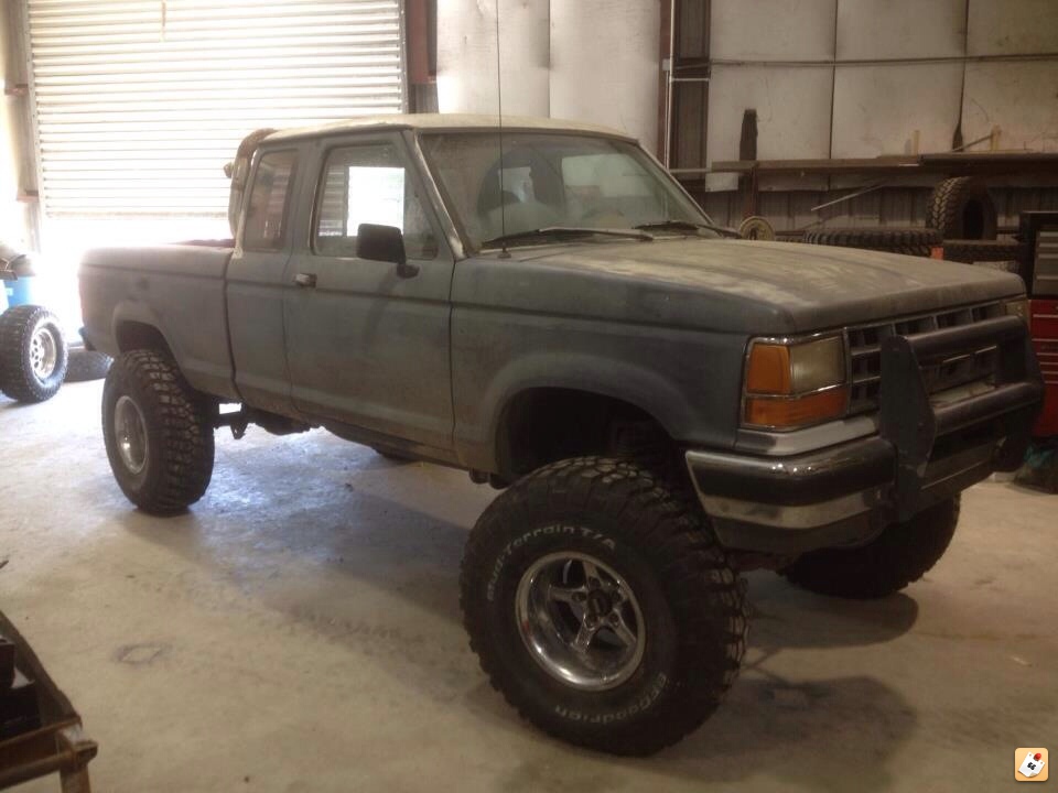

I'm wanting to put a 5.9 cummins in my ranger and I need help as far as what is the best way about doing this? I've seen it done to a newer model ranger and a 2000 dodge Dakota so I know it can be done to mine, please help

I'm wanting to put a 5.9 cummins that I've recently acquired in my 1992 ford ranger 4x4, what all is needed and what do I need to do or know for this project to proceed? All help needed.
