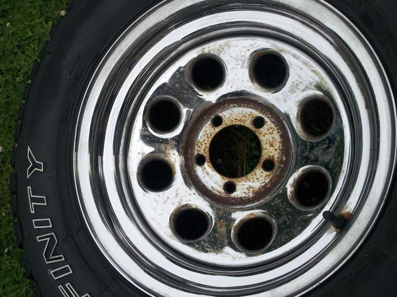

1st, I removed the wheels and gave them a bath. After they were dry, I took a bit of tin foil, balled it up and used it to remove the rust. Apparently, a lot of bikers used to do this to clean up the chrome on their Harleys.
Here is a pic of one of the wheels. You can see there's scaring done from the rust so even if I polished these guys up, I'd still have rust.

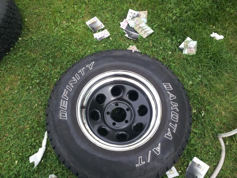

After the rub down with the foil, I took a deck of cards and over lapped them. It's easier than using tape and keeps it all contained. Here are pics of a wheel with the cards. One is cleaned up with foil and the other is the same wheel with one coat of Plastidip. You can see that one coat does a lot!
If you look hard enough, you can see that I definitely needed more coats. You can also see that the finish is matte so if that's what you want, no need to use the clear coat.

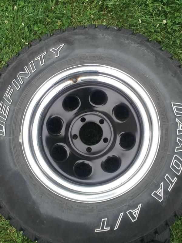

I sprayed a total of 4 coats on each wheel. After that, I ran 2 coats of clear. Here is after 1 coat of clear.
A little bit more rust needs to go off the lip but here is the finished product. Again, 4 coats of plastidip, 2 coats of clear!

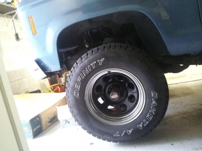

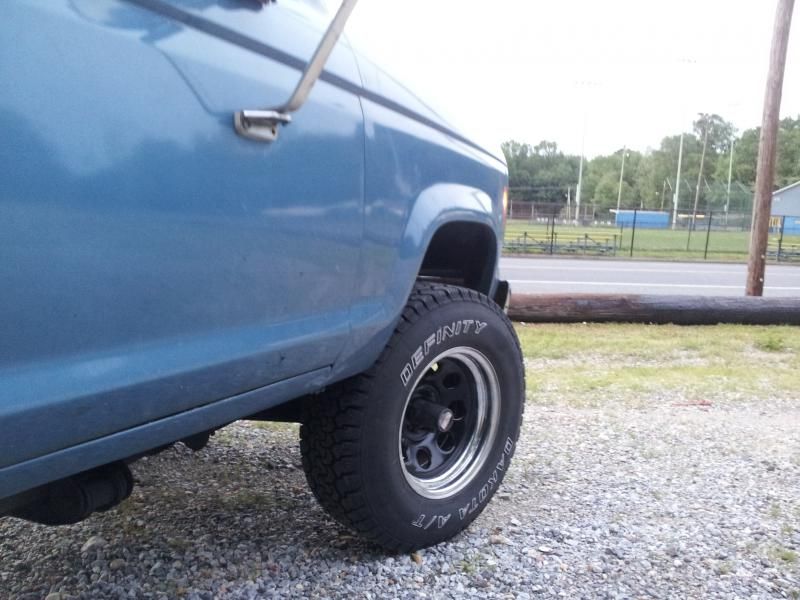

Mounted up!
It's lasted almost a year now and the even the lugnuts have survived getting hit with an impact gun from time to time.
