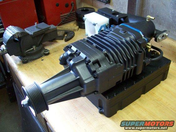

I sourced a rebuilt and painted supercharger and have ordered a kit from Banshee.

I got a kit from Banshee, looks very good and complete. Much help was offered by Ron, Thanks!

The paint job was not done by me, powder coated, diamond black by the guy I bought it from.

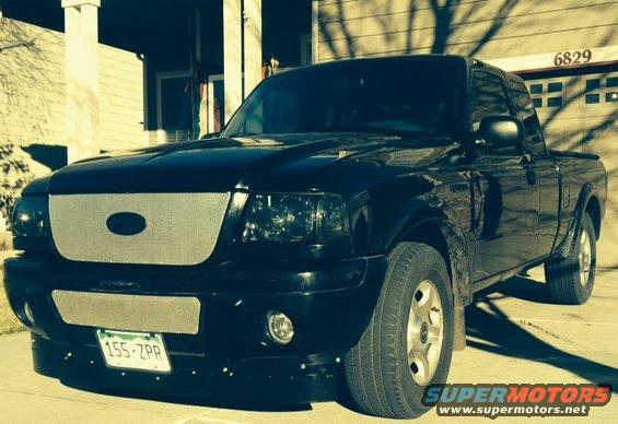

I pulled a bunch of weight; the jump seats, side steps, rear bumper, sub woofer, spare tire carrier and tailgate to name the bigger items. I am also trying to make it more slippery, closed off 75% of the grill openings with aluminum mesh and installed an air dam. Next is a cab back visor, with the bed cover, combined they reduce drag about 18%.........

New Whale tail spoiler! OK it's small, probably added at least 10lbs of downforce at 90mph and some drag, but I like it.
