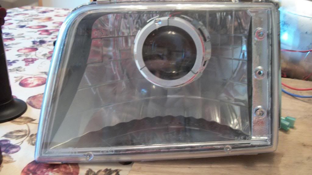

This is my 2nd retrofit. The first one was on my Honda street bike. Retrofitting my truck headlights was much simpler. I got the ballasts, projectors, bulbs, and angel eyes from www.theretrofitsource.com. They are located in Atlanta, GA. The price for all of this shipped was about $375. The red led strips I got from eBay. It's very simple to do, just time consuming.
I put my headlights in the oven at 325*F for about 10 minutes. The glue on the clear headlights is kind of strong. I'm sure it's the same for other Ranger aftermarket lights.

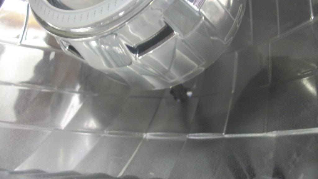

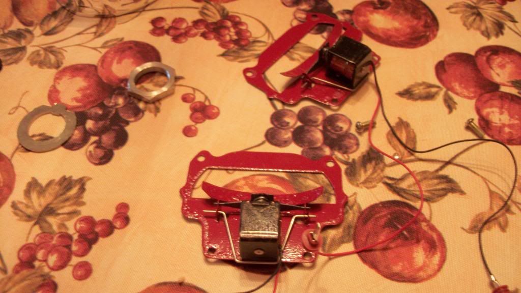

High beam shield painted black with 500*F engine paint. When the sun hit the projectors it gives off a red glow:

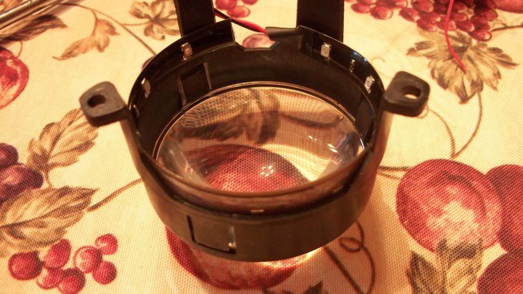

The angel eyes are nice and thin, about 2mm:

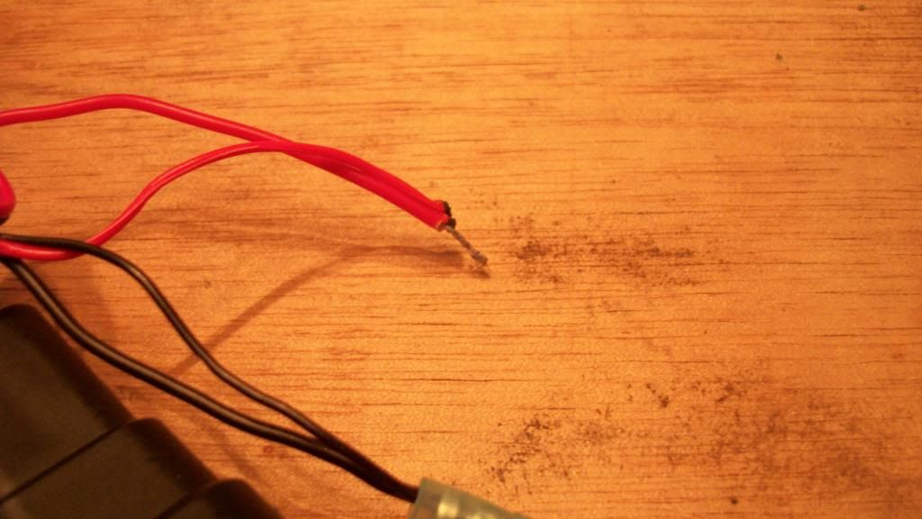

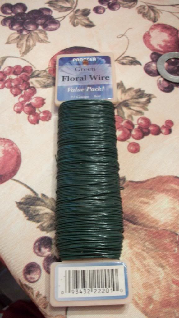

This is the wire I used to attach the angel eyes:

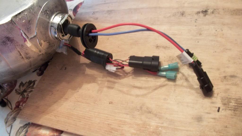

Wires ran out the back of the housing. They include the high beam solenoid, angel eye, and led strip wiring:
Everything is labled clearly. This plug is for the high beam solenoid:
The 9007 relay harness. The white and blue wires in the Morimoto plug had to be swapped for proper high beam operation:

9006 plug for high beam solenoid installed and blue push-ons for LED angel eyes crimped on:

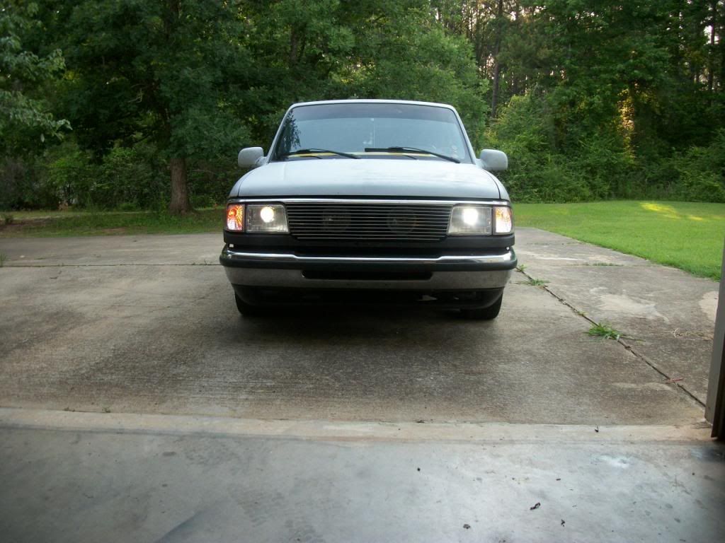

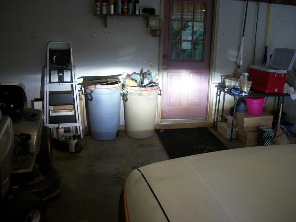

Low beam:
High beam:

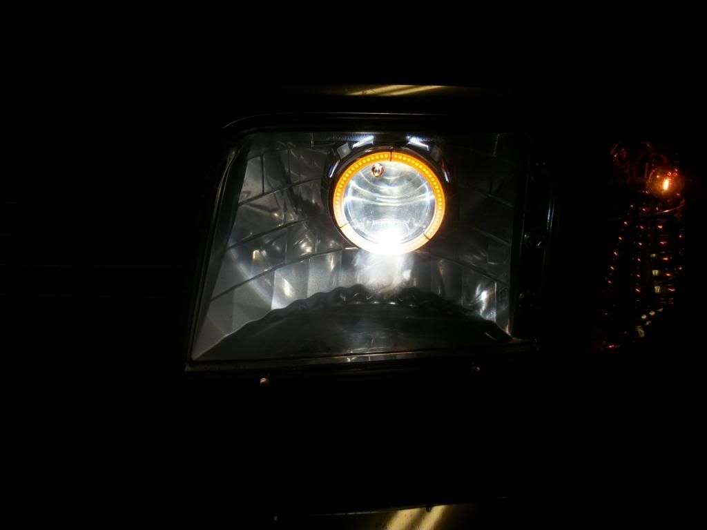

Angel and demon eyes:
HIDs on:
