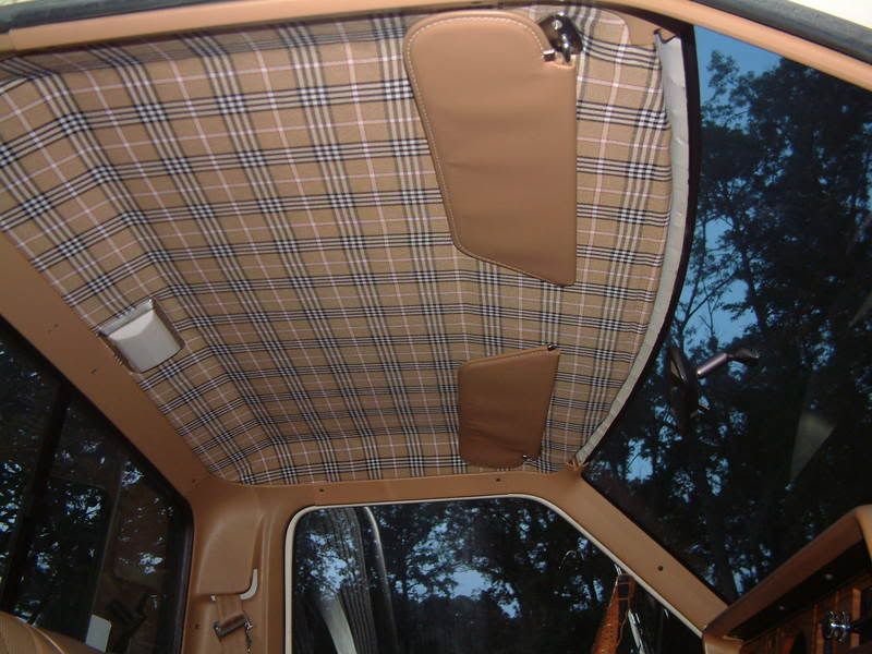

heres mine ...burberry :P

so did you rip out your previous headliner to put that in or did you put it on over the old one im interested in replacing mine with black silk
no. that fabric that s from the factory is REALLY REALLY THIN! so you can just spray your adhesive right over that. works fine
