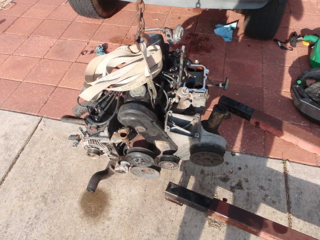

thx guys for the positive comments, i appreciate it. got the engine out today, pretty happy about it, tired too, still runs so hopefully ill be able to make a few bucks off it on craigslist.

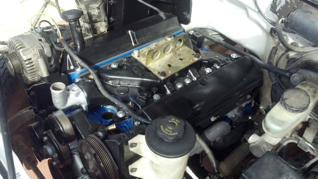

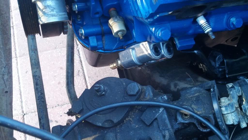

engine mocked up in the garage, had to shave alittle of the power steering and a/c bracket so i could turn my distributor more sine the vacuum advance wanted to hit the bracket.
its in. not happy with the way its sitting, the passenger side is about a 1/2 inch closer to the radiator then the drivers side, its offset to the passenger side an inch, just didnt do a good job cutting the slots, was debating a body lift but now it looks like it will help out, so ordering that tomorrow. gonna lift it back up and see if i cant get it set where i want it. also the drain plug clears the bracket behind the clossmember.

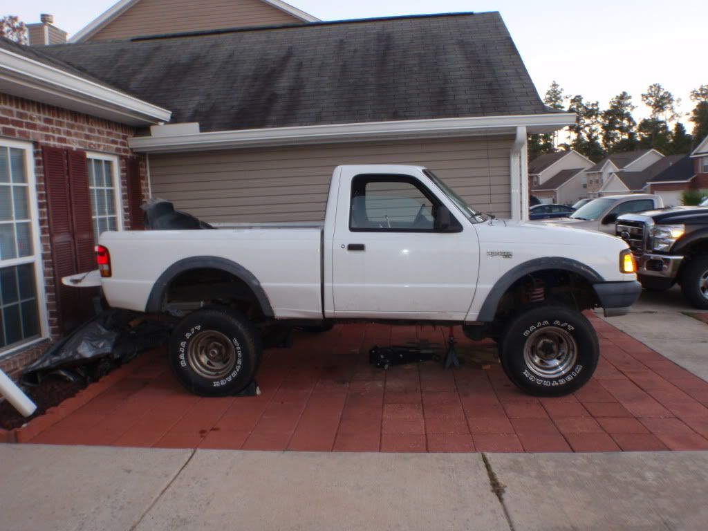

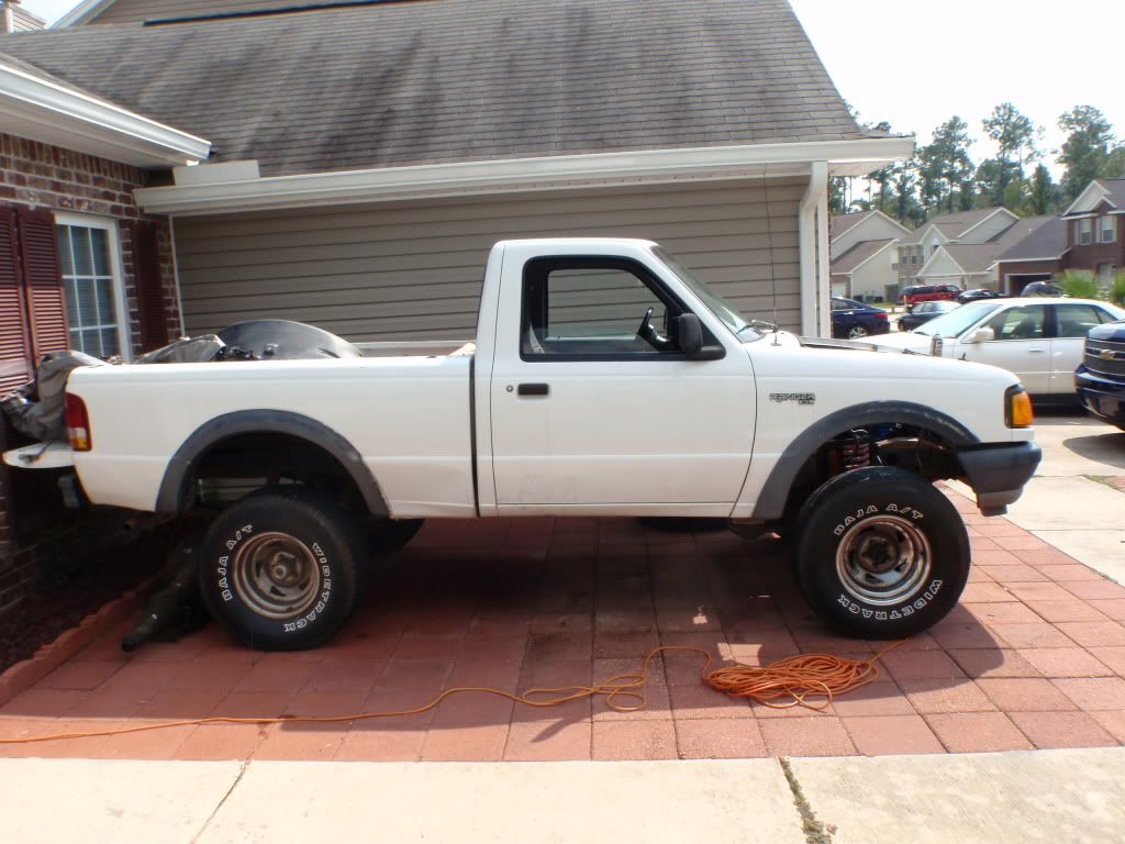

go the body lift on, used performance accessories 2 inch kit, didnt give me too much trouble for the most part except the front bumper mounting brackets, bad instructions so i just kept modifing the brackets that came in the kit little by little til i got what i liked.
before/ after

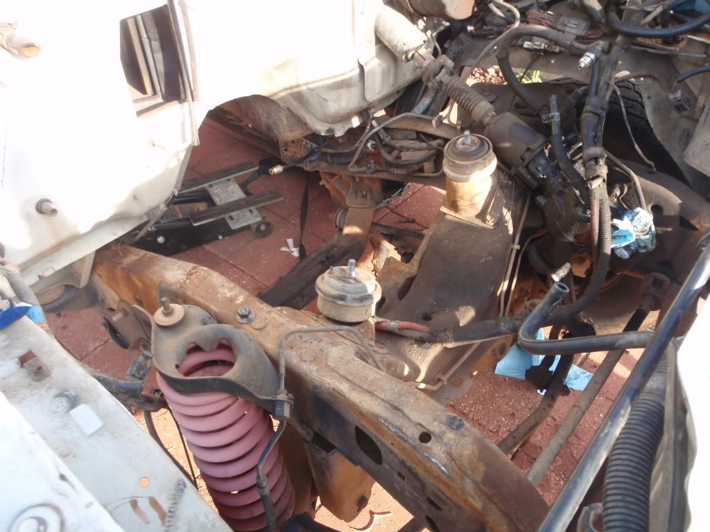

got my heater box mod done, the radiator is the old one, just in there so i have something to go off of. finding a new one is next on my list. got started on the wiring this past weekend. tilts back a little since i just have the trans held up by a jackstand.
