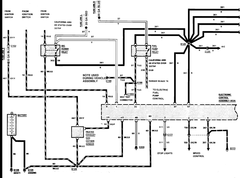

I used this found it on here.
(The fuel pump relay has five wires.
yellow:from the fusible link at the starter relay.Always live.
red:from the eec relay.
tan-lt green:from the ecu.
orange-lt blue x2 :to the inertia switch and the ecu.)

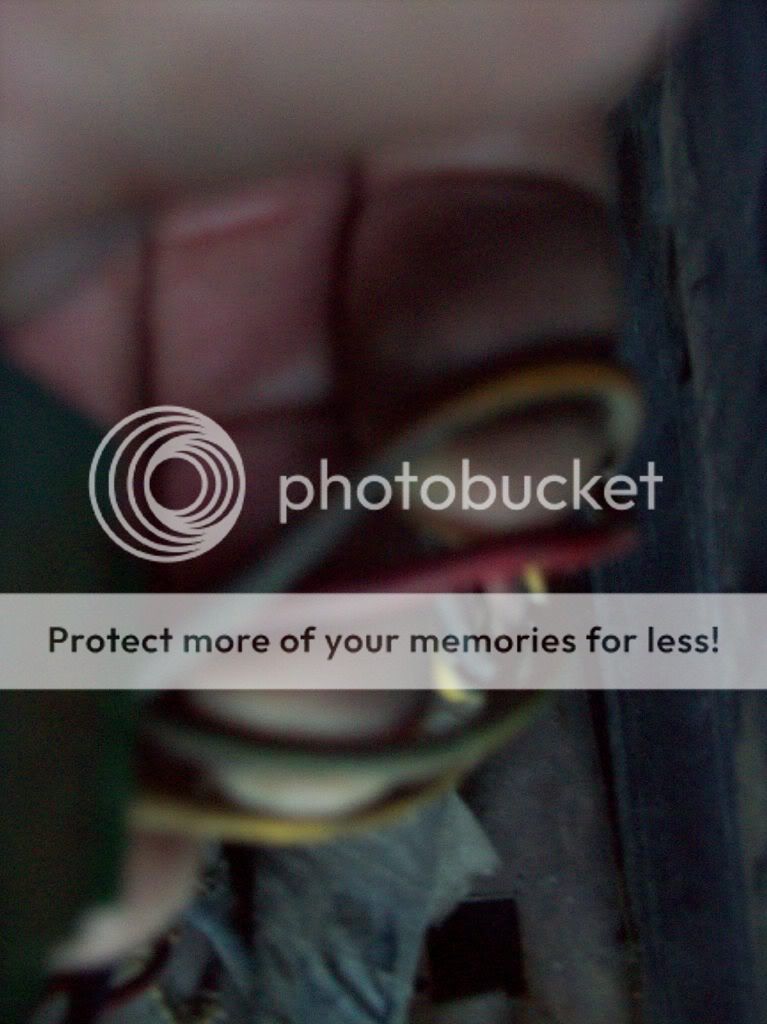

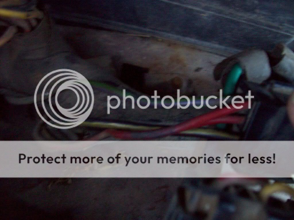

no tan and green wire.I took pictures left to right is front to back the one on the right should be fuel pump right?
Middle relay (green one) wire colors
Left relay (black one) wire colors

From left to right those are
PCM power, Fuel pump, and A/C/ WOT cutout. Fuel is green.
