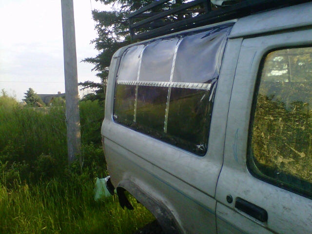

Having quote for custom canvas rear side windows be made, anyone interested in purchasing?
I've been thinking about making my own, that snap on. Also plastic tinted windows like soft tops have. I would be interested in what you have, if the price is right, and you have good pics.
Guy made windows and installed, $115. I'm having problems getting pics up, if you send me your e-mail I'll send the pics to you.
Window pics BII

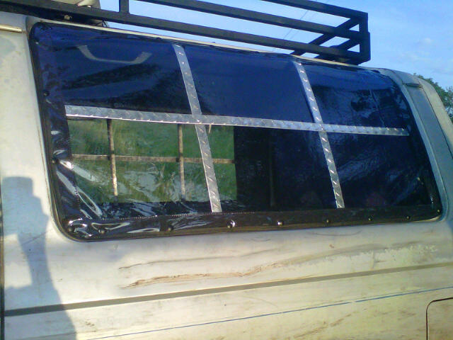

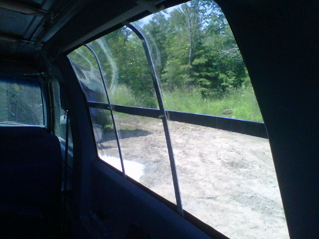

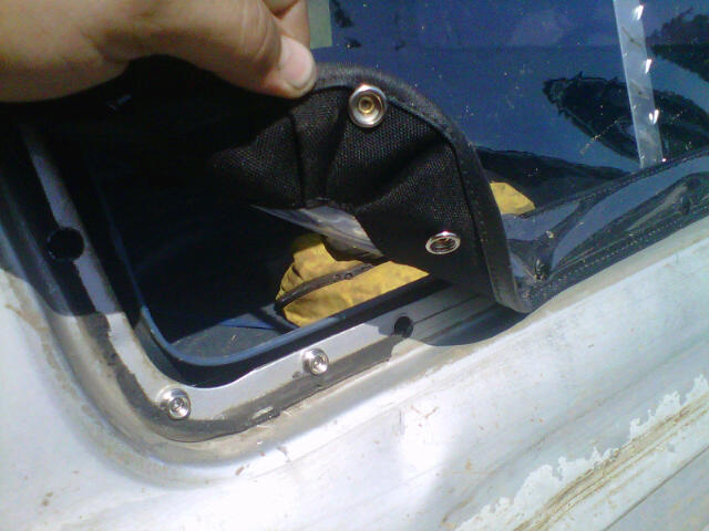

Are the bars part of that deal, or something you did seperately? Also, how thick is the plastic? And.....Can you show a closeup of the snaps, or attachements? Maybe a shot from inside, too?
Thanks! Looks pretty good.
The bars I installed myself 1.to keep the body shape 2.keep brush from hitting people in the back seat when windows are removed and 3. so the windows have something to strech over, 1/8" x 1" aluminum diamond plate pop riveted in place. Drove down the highway at 55 mph (with 4.88 gears bout as fast as the bugger will roll)with no noise from windows rattling in the wind. The snaps are heavy duty boat snaps.
