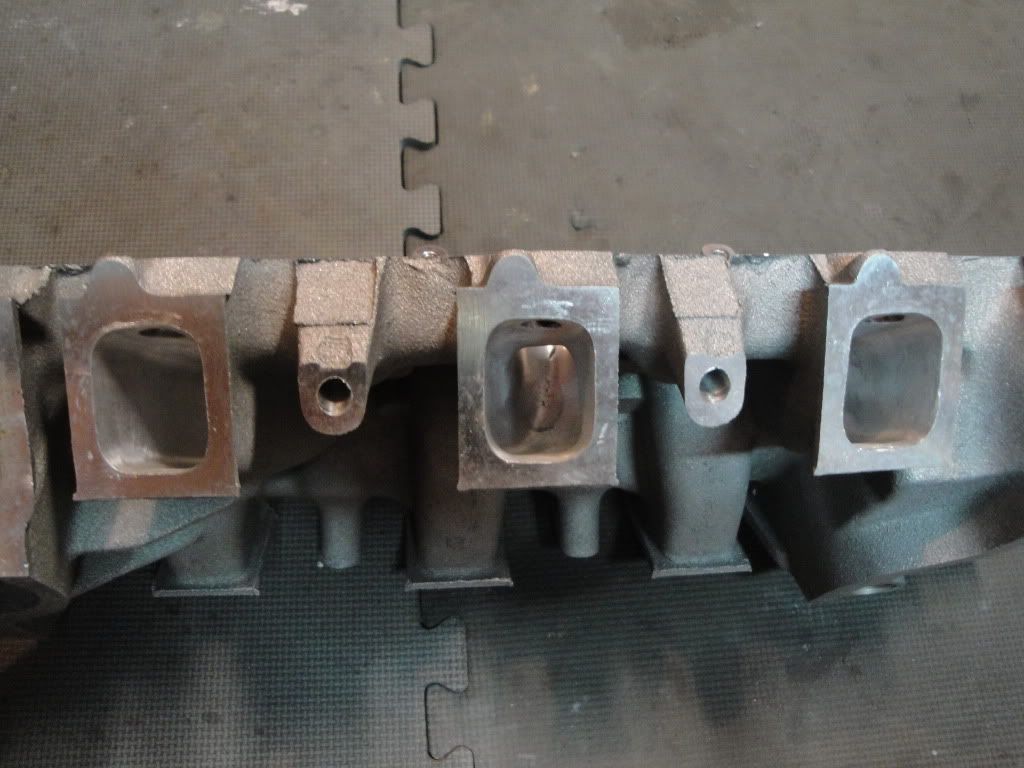

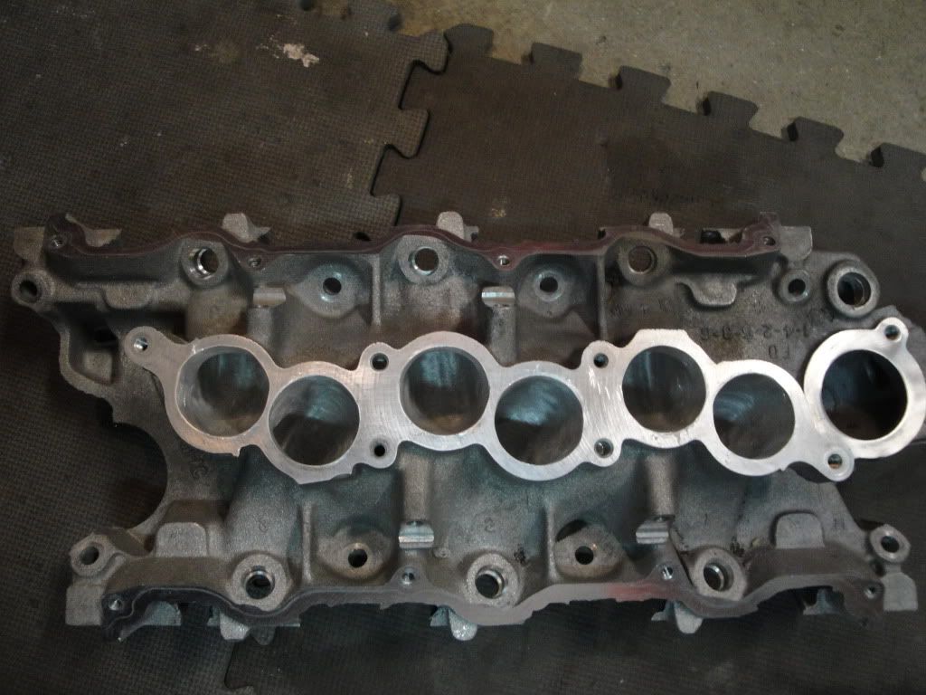

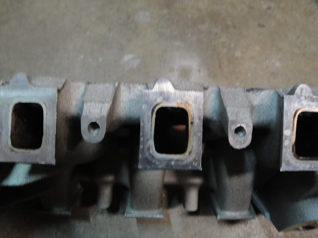

Just wanted to post some before and after pics incase anyone was interested. I gasket matched the ports as deep as I could, and focused on smoothing and straightening the truns as much as I could. I took some measurements, and the round intake ports were increasaed in area 15%, while the rectangular exhaust ports were increased 29%!

Ok, so this can't hurt, but what is it's real value? The openings at the gasket mounting have been enlarged but if you look down the passages they narrow by design which means their flow ability has not changed. Getting rid of the port entrance edges and polishing will reduce flow turbulence (which is good) but will that mean anything when the flow requirements are the same. If the rpm of the engine were to be increased and/or larger pistons installed where a larger flow rate (cfm) was created I might buy this as a good mod. To do this when the manifolds are off anyway is OK, but to tear into the engine just to do this seems a waste. I accept better flow ability is good but what is the science behind doing this on this engine?

I used a spare manifold for the job. The ports were enlarged somewhat all the way through, not just near the outer edges. They don't narrow as much as they change shape, going from circular intake ports to rectangular exhaust ports. I also focused on making the passage as straight as I could so it will flow more air, and the smoother laminar air flow is a plus. It's possible that Ford kept the passages small in order to keep the velocity of the air up. I wasn't too concerned with that though. It's going to be mounted under my whipple supercharger and force fed as much air as it can take, so I wanted to let the thing breathe as much as possible.
It's really just about efficiency. It's easier to flow air through a smoother, larger opening than a rough, smaller one. The ported lower intake may drop the boost from the supercharger a little, but I can always increase the boost with a smaller pulley. So, a 2.75 inch supercharger pulley, that makes 10 lbs of boost on an otherwise stock engine, may only make 8lbs with this intake. But, while the amount of air the stock manifold can pass would have been close to maxed out at 10 lbs, the ported intake has a much higher threshold, and will produce much larger gains at 10 lbs than the stock engine at 10 lbs. Basically, ported intake and headers at 10 lbs of boost is closely equivalent to maybe 14lbs on a stock motor (as far as the amount of air flow) and puts much less strain on the engine. My goal is to make as much power as I can, at the lowest possible amount of boost.
Looks good, nice work. Did you remember to keep the openings slightly smaller than the gasket to account for squish of the gasket so that the gasket doesn't impede flow when bolted down?
I have a bunch of junk valves laying around that I can use to keep all the round ports the same while porting. On rectanguar ports, I trim out a piece of sheet metal to match the shape of the gasket opening then use it to match all the ports while porting. You also need to keep a gasket handy so that you don't end up off center.
