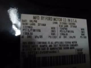

actually because it was a xl not xlt it came stock with 215. still has original door sticker, 215/75/15
Post a picture as proof. I had a 99 4x4 XL model and the door sticker specified 235/75R15.
pic of door tag
original door. original sticker. now whos the idiot. the 99 ranger xl bottom base model had 215s!
Easy there turbo, I didn't call you an idiot and neither did anyone else. I simply asked to see a picture because I have never seen that. I had the base model 99 4x4 xl as well, that's why I was curious.
