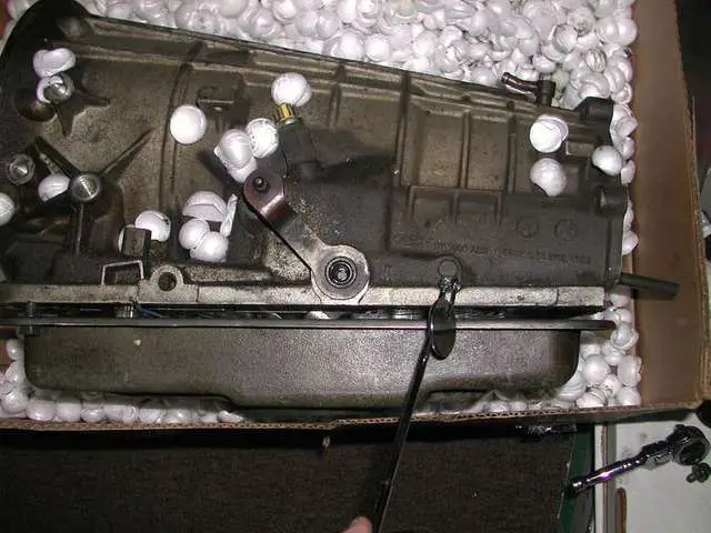

Any tuts out there or any advice from you pros? How do I go about installing a temp gauge for the tranny also?
Oops please move to transmissions forum...
I believe there are 2 flex lines for the cooler right underneath the radiator for the stock cooler. They connect to hard lines that run back to the tranny. I would just mount the cooler, run some flex lines to it, and reconnect to the existing hard lines. The fluid should run through the stock cooler first, then the aux. cooler, then back to the tranny. For the temp gauge, theres a bolt on the driver's side of the tranny near the shift linkage. It's a port to hook up a pressure gauge to test tranny pressure, but you can use it for the gauge. It uses 1/8" NPT thread. Here's a pic of it I found: (The guy is pointing an inspection mirror at it)
