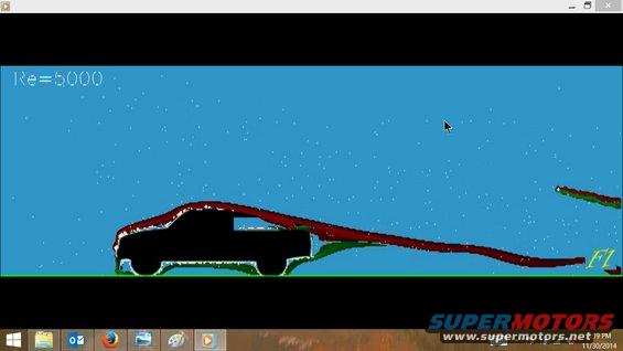

Playing with Flow Illustrator. Note green vs red are opposite flow/drag. Playing is my biggest objective here, but I think I improved handling a tiny bit and mileage. I am not looking to get the handling improved to the point to autocross nor huge mileage gains!
Stock Extended cab:
Tailgate removed:
Bed Cover only:
AeroRanger: Front air damn, cab back visor, and Tonneau Cover:
I read a study that claimed a reduction of drag (Cd) of 18% with the combination of the cab back visor (19" wide and angled down at 11 degrees for a short bed & 21" and 12 degrees down for a long bed) and a bed cover. An aeroshell reduces drag by about 20%.
I have installed a small front air dam. I will add material to drop it down further. The dam needs to be at maximum about 6" above ground to decrease lift without increasing drag much. I assume the dam always adds drag but in pushing the air around the vehicle less drags underneath. At 6" from the ground you get about 6% increase in drag but about 30% decrease in lift. At 3" it does not add drag and you get over 300% decrease in lift!

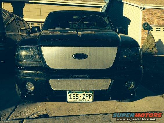

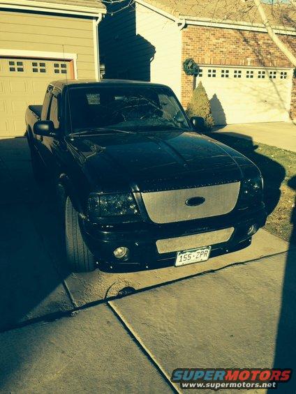

I installed an aluminum mesh over the grill and lower opening that allows for 25% flow through. The thought being to reduce drag of the air slamming into the radiator and to get more flow to go around. I don't know how effective it is, but I have noticed no boost at 70mph on the same stretch of highway where it went into 1-2lbs before. This after I lowered it a bit too which also helps reduce drag.
I am going to make a cab back visor and report back. My best measure being boost level at 70mph down the same stretch of interstate.

I will be watching my rig in the spring to make sure it doesn't overheat and I don't tow or haul so probably don't need all that cooling. I'll also have to keep the mesh clean, them little holes, 3/32 will clog easily..........................

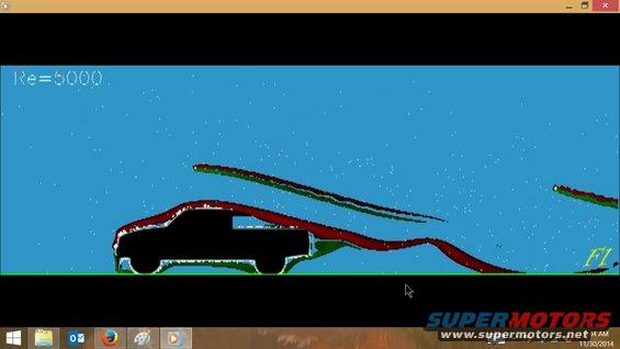

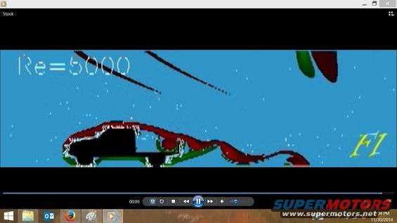

So Here are screen shots:
Stock

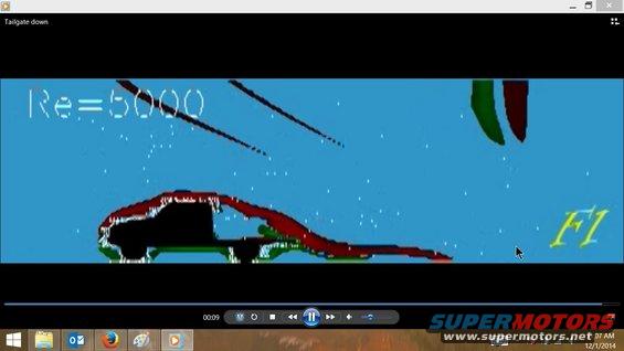

Tailgate down:
Bed cover & dam:
Dam, cab visor, & Bed Cover
Dam, cab visor, Bed cover & wing
Aeroshell with taper at back:
I thought that there had been studies done that by removing the tailgate actually hurt performance. Even when running with it down did not matter.
Yup tailgate down or removed does cause more drag with an open bed, but I run a bed cover.
I added a screen shot above. A progression from stock to my future plans.

The program doesn't show much difference with skirts, but I know there is a positive effect. It's the limitation of Flow Illustrator.
I will likely get to adding some skirts down the line........................maybe some belly pan work, wheel spats like in the thread you refer too, and perhaps cover the fog lights with amber lenses.
I won't likely do the wing, I only saw slight improvement at high speed.

Pics added to the series above.
My next two things to do will be to extend the dam down with rubber (rubber so I don't break it) and make me a cab back visor from sheet metal.

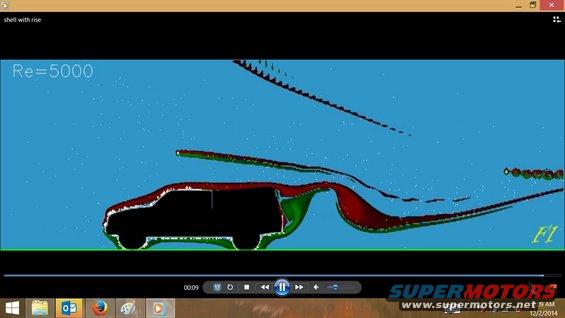

I was wondering if a camper shell would have any effect? I am talking about the kind that is small in front then gets a little bigger in the back and fiberglass. It would seem to be smooth but more weight?
Added weight hurts mileage more in stop and go, around town. The added weight of the shell is not that much though. Once you get up to speed, the added size will create more drag at the back. It would likely add some down force if it gets bigger towards the back.
You can see the flow pushing down on the shell and the big wag in the flow behind the rig is drag.
