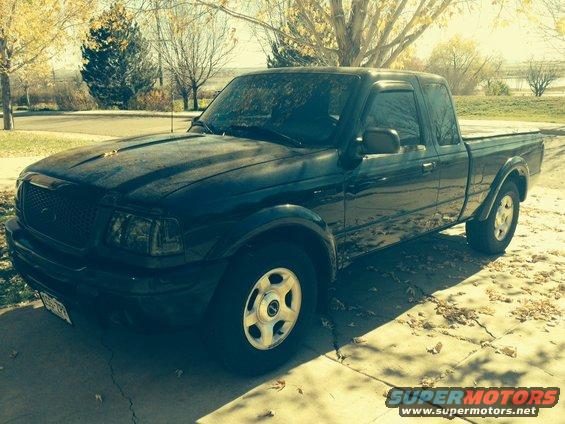

Blown, Lowered, Lightened, Aeroed, 2001 Edge Extended Cab

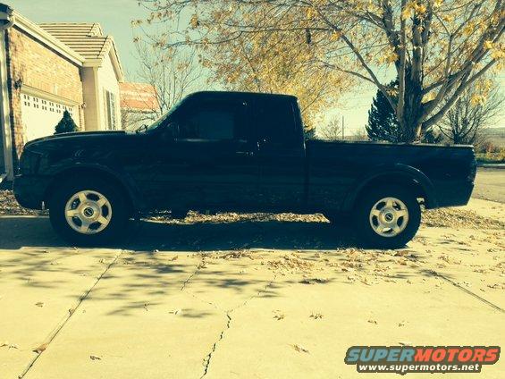

My goal was to increase handling and ride. I put on 255/70R15's
I cranked the front down. Out back, I cut down the overload leaves, removed the 2 1/2" blocks, and cut down the bottom leaf to lower the spring rate. I felt the need to reduced the spring rate as I removed weight. I was bouncing all over hell. I'll add that removing the heavy blocks and leaves lowered the unsprung weight which helps handling.

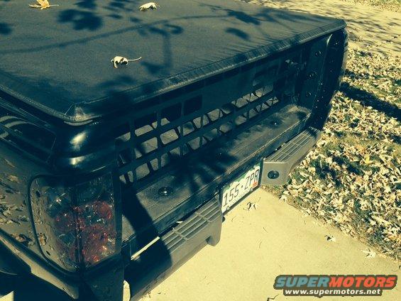

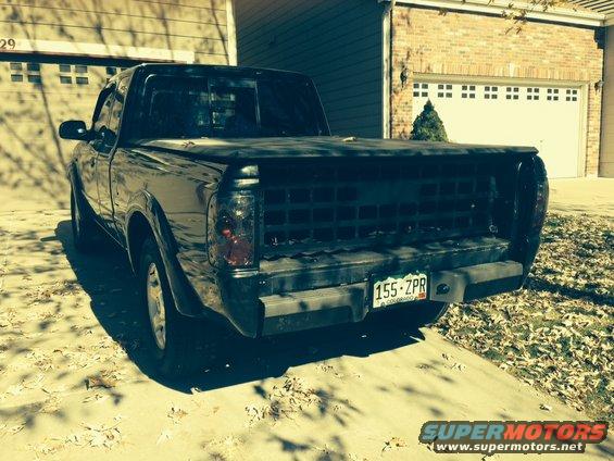

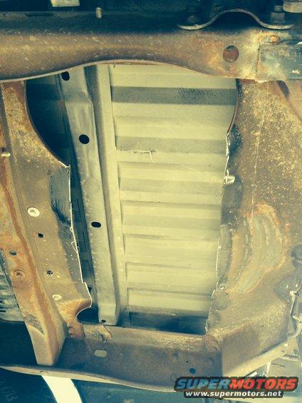

I removed the jump seats, spare tire holder/crank and section of frame cross member it was mounted too, removed the 2" towing hitch, tailgate and cut down the rear bumper.
I moved the spare tire up in the bed behind the cab to redistribute the weight to a better place. Note that everything I took off, accept the seats, was behind the rear wheels. Taking the weight off there helped handling considerably. There has got to be at least 100lbs removed back there which had leverage and was adding to the force trying to swing the rear end out when cornering.

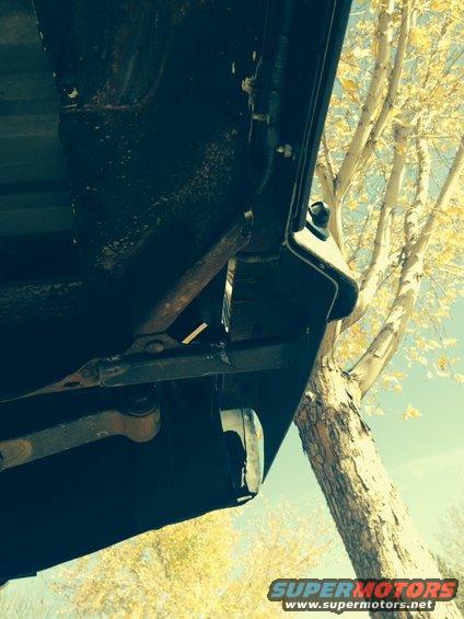

Shot's of the bumper, frame cross member cut-out where spare tire carrier was removed and a closer shot of rear. I got too much time on my hands today.

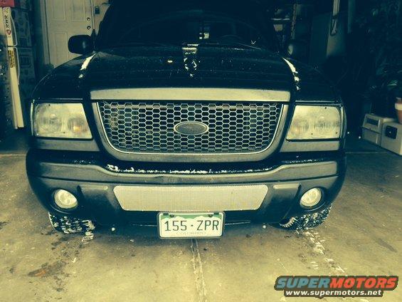

I covered the lower air intake on the front, where the tow hooks poke used to be, in with a tight aluminum mesh. I think it should allow air in but also cause some to flow around and thus create less drag. After doing it, I believe the material lets enough air flow through to do the grill and will do that next.

I do feel that it corners better now. I lowered the spring rate to account for the weight loss. I also lowered the rear of the truck 2 1/2 to 3" so moving the spare up a few inches would increase COG slightly but I believe I got the better of a trade-off. Moving that weight in front of the rear axle is better than having it aft of the axle trying to pull the rear out and around in a corner. I also removed a 2" receiver tow hitch, most of the bumper, and the tailgate. That's quite a bit of weight. I know getting that weight out from behind the axle helped cornering but I should have noted. Note Here: After taking everything off and out of the bed, I did find that putting back in the spare tire and tools in front of the bed and one 60lb sandbag over the rear axle helped handling, ride, and cornering.
