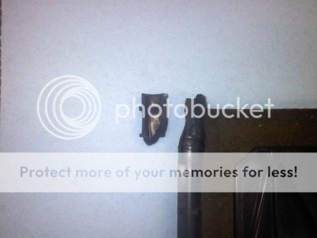

Top of the door is split where the shaft inserts.

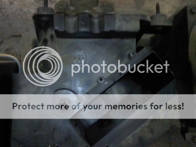

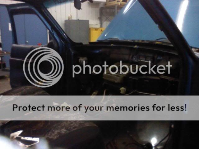

I pulled the dash and the HVAC plenum so I could finally fix the blend door.

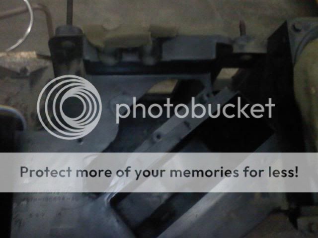

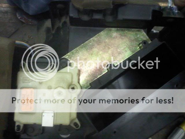

I used the Dorman blend door replacement kit (Part #5526-05055673). It ran me $11.99 + tax at Advance Auto Parts. This kit comes with a pattern to cut a hole that will allow you to remove the blend door with out splitting the plenum. The kit also comes with a new door (with a beefed up pivot point) and a new plate to cover the hole you cut and provide and mounting location for the upped pivot.
I just heated a razor blade with a micro torch and it cut like butter.
Here is the busted door next to the new one.
The plate will cause the motor to sit uneven since it is only under one screw hole. it would probly be okay, but I went ahead and slipped a washer under the other two mounting screws to level it out (I dont want to fatigue the shaft and have to do this agian.)
