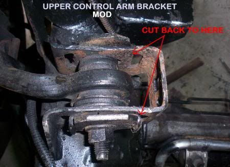

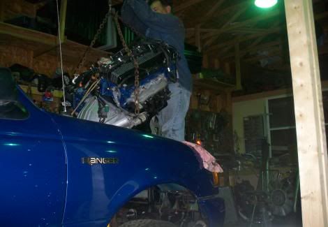

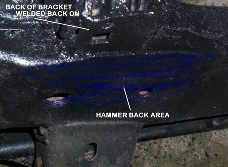

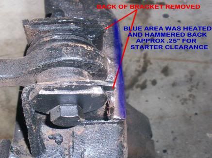

Set the engine in this morning and it didn't fit like it was suposed to, last test fit was without the starter on and it was now rubbing the upper control arm bracket on the passengers side.(It fit between the frame rail but it was touching), I had done some grinding on this for the header flange but didn't think the starter was an issue. Also the holes I drilled in the motor mount plates were a little to far back, I could have gotten it in but I was working by myself and it was easier to drill new holes 3/4" forward and drop it in, had plenty of room forward.
Here is what I had to do for the extra room for the starter.
The bracket for the upper control arm stuck out a little past the edge of the frame and had to be modified.
bracket
I cut the rear of the bracket off and ground it down to move it back about 3/8", about 1/8" inside thr frame rail. I heated the frame rail with a torch and hammered it back about 1/4".
I rewelded the back or the bracket and painted the area.
I redrilled the motor mounts and set the engine in again. This time it was a success, it dropped right into the mounting holes. yaaaahoooo!
oops celebrated too soon. The header flanges on both side were still touching the control arm brackets. I raised the engine up and put some 1/2" shims under the mm and it raised the engine just enough to clear everything.
It really looked good sitting in there

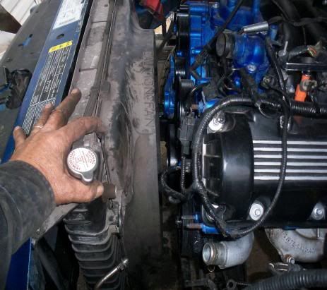

Dropped the new radiator and shroud into the front and as you can see plenty of room, I'm going to try to use the CV elect. fan and graft it into the fan shroud, that's another project.

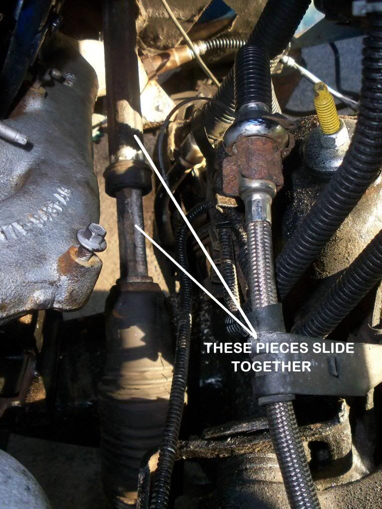

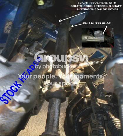

Had a beautiful day today and worked on exhaust and steering. It was really a blessing when I went to check the fit for the steering linkage. It slide right into place, it fit great. When I went to install the bolts that hold the linkage together I found that the huge nut welded to the linkage hit the edge of the valve cover, it would twist pass but I don't want to leave it like that.
[/IMG]

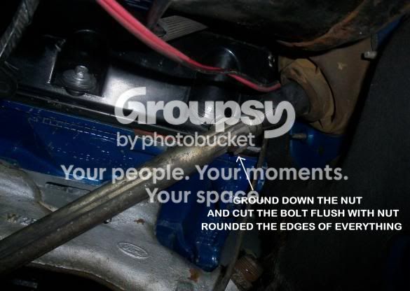

I ground the nut down and rounded the corners, cut the bolt off flush with nut and ground off nut and cut and ground the head of the bolt.
[/IMG]
Everything misses now but I'm still not satisfied, if the motor would torque a little it might pinch at the wrong moment.
I believe I can shift the steering linkage over a tad by loosening the bolts on the firewall. I was amazed, the lower end dropped right on. The exhaust manifold even had a little bow in it that gave the linkage some room. Thank you Lord!

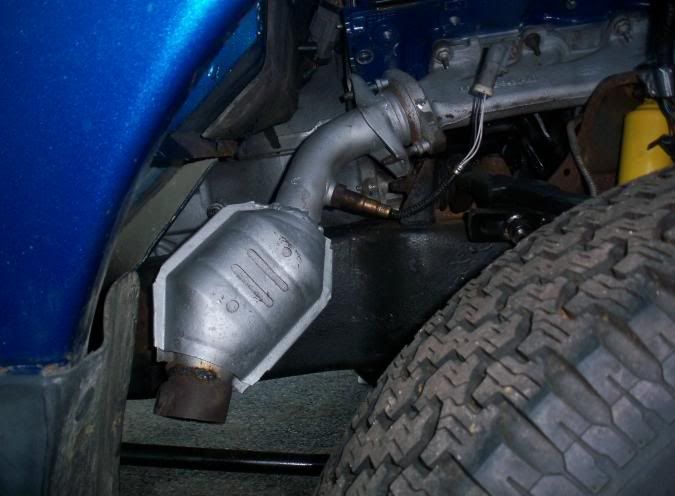

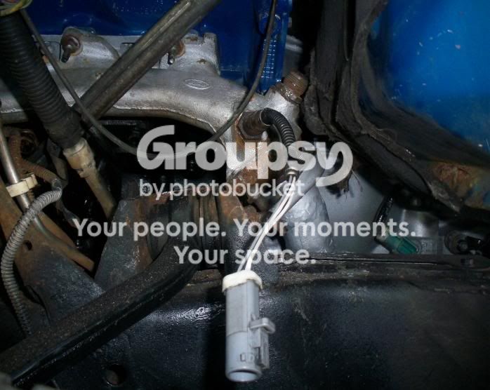

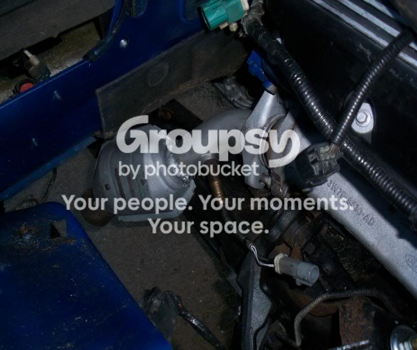

I ordered a set of 50" side exhaust pipes from JC Whitney. I fabed up the cats off the manifolds, the pass. side rolled outside the frame nice, plenty of wheel clearance. Will have to wait for side pipes to come to see how the outlet side off the cats will connect, thing are a little tight here.
[/IMG]

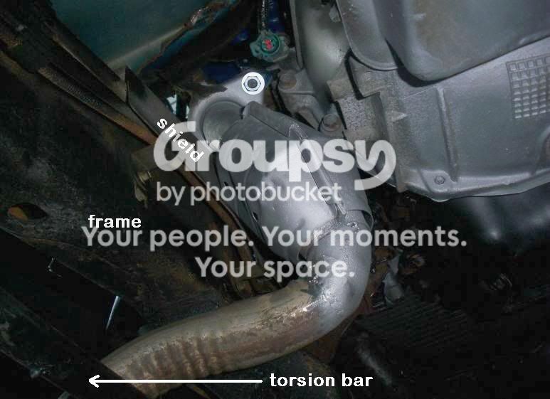

The drivers side is another story, the manifold aims inside the frame rail here and it goes between the bellhousing and the shield on the frame for the gas and brake lines.
[/IMG]
I need to get outside the frame and the best place I see is up front right between the frame rail and the torsion bar, problem is this is pretty tight turns from the cat but it all fit. This mig welder sure is the ticket for this work.

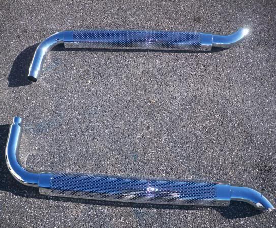

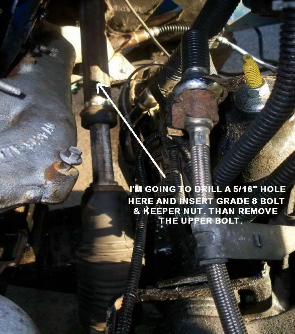

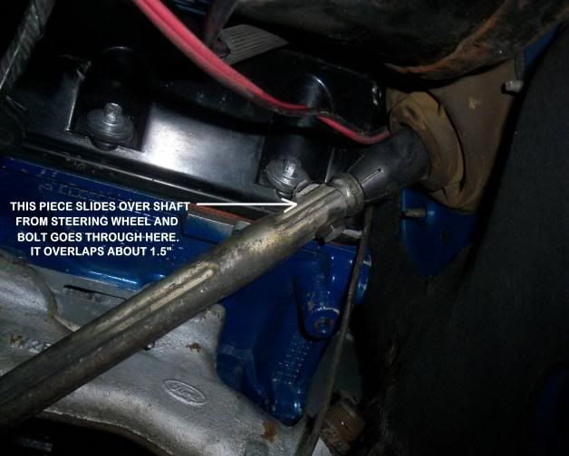

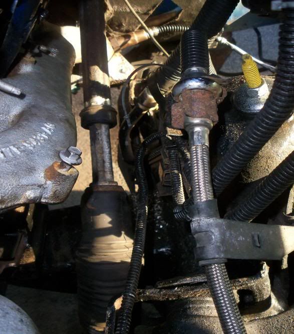

Received my side pipes today from JC Whitney and the look great, raining today so I took the day off but looking at the steering linkage I think I've found an easy fix for the tough squeeze.
Since the steering shafts slide over each other in order to install over steering wheel shaft as shown here.
This is where the rub is , I'm going to remove this bolt and grind the nut off to eliminate the interference. The amount of overlap is more than enough.
I'm going to drill a 5/16" hole through both pieces on the shaft. This bolt will replace the one removed at top of shaft and serve the same purpose.
This will eliminate all the steering linkage problems easily.
Steering
http://i1192.photobucket.com/albums/aa327/RJAAAAAA/STEERINGLINK1.jpg
i wouldnt go that route if you dont have to. try a different setup. i agree likely you will be fine, but modding the shaft further up to accept a different one may be a better way to go.
Thanks for the input, what do you see as a possible problem here. I believe I'm still going to put a pin in the upper piece that will stay flush, maybe some JB weld on top just to hold it in but still be able to remove it if needed.

Side pipes came today and they look great. The chrome looks A1 but I did as the instructions read and polished them with some good chrome polish right out of the box. These are 50" long, I held one up under the truck and I think these things are going to look great. Worked on the pipe connection from the pass. side cat. today. Geeez they're calling for snow here tomorrow, I'll have to move into the garage I guess.
