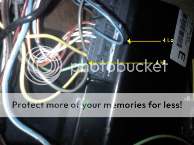

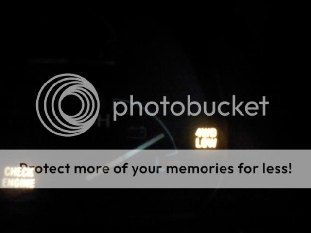

I put my manual t case in and got the console/shifter issue all taken care of a couple of weeks ago. So I decided to get the indicator lights working.
The switch on the t case just grounds out either the 4 low wire of the 4 high wire.
I looked at the 4x4 system wiring diagram and found out the blue/black wire going into the GEM (located just to the left of the radio) is the 4 lo indicator light ground, and the solid gray id the 4 hi ground. (there are two gray wires going into the GEM, its the lower one on the plug.)
So all I had to do was connect the two wires from the tcase to the two indicator light ground wires coming from the cluster.
