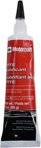

Once it’s clean, put a good coating of marine grease on it.
Ford actually offers a lubricant for slip yokes:
Genuine Ford Fluid XG-8 PTFE Lubricant – 3 oz.
