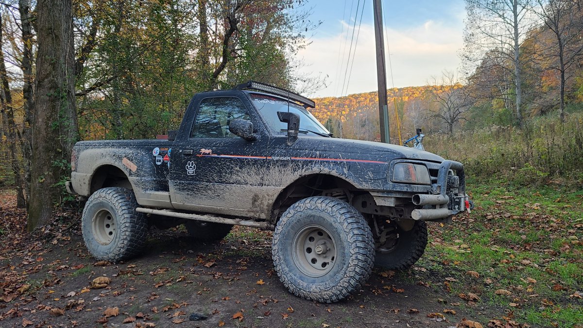

That sounds spicy. You got a pic perchance? Im nowhere near a lift lift for the foreseeable future but id like an idea of how it looks
And anyone else for that matter please post up pics of 15x8s if ya got em with your tire and specs
Pictures everywhere. Build thread linked in my signature.
