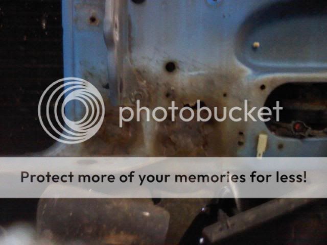

WTF?! Body mounts rusted off front clip

The repair looks tidy. Seal the seams well before paint.
As always Pete thanks for your good comments.
I laughed a bit though when you wrote "before paint", and I don't mean any offense to you, but painting that new panel is like trying to polish a turd. It just doesn't make sense. The truck is too old, has too many miles, and is waaay too rusty to care what the paint looks like inside the engine compartment. The new rad support has a good finish from the factory that I have to believe is better than the rusted out panels I connected it to. When I get back to working on the Bronco that'll be a different story but as far as the Ranger it's always been more of a 'make it work' approach.

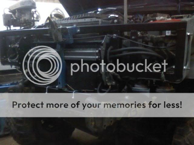

I fixed mine so it wont happen again. I simply replaced the entire core support with box tubing.lol

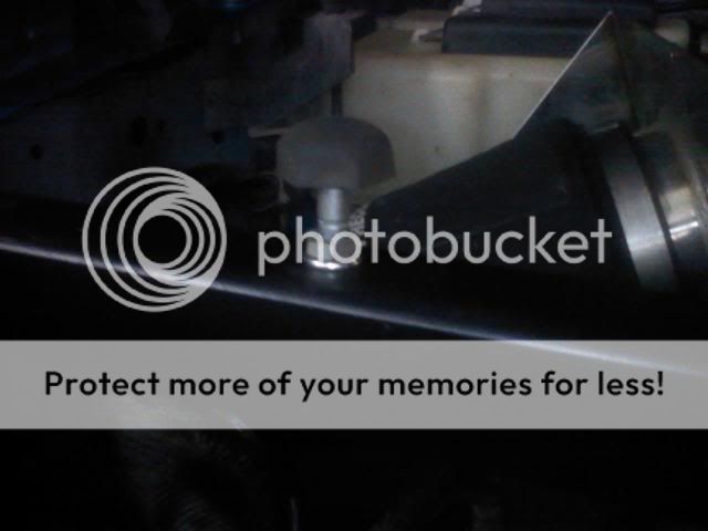

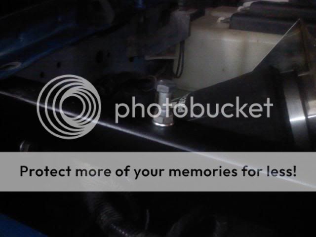

I managed to get the hood latch to line up perfect on my first try. Poppe the rubber bumper off the stock hood stops and popped them over the head of a 5/16 bolt to make the new ones.

Awesome job on that....
May I suggest, perhaps, turning on a light when you take pics...lol...I could see everything but not as clearly as I'd like to...you know I can't copy that work without seeing the fine details...:icon_thumby:

Those were pics I took with my old cell phone.lol.
