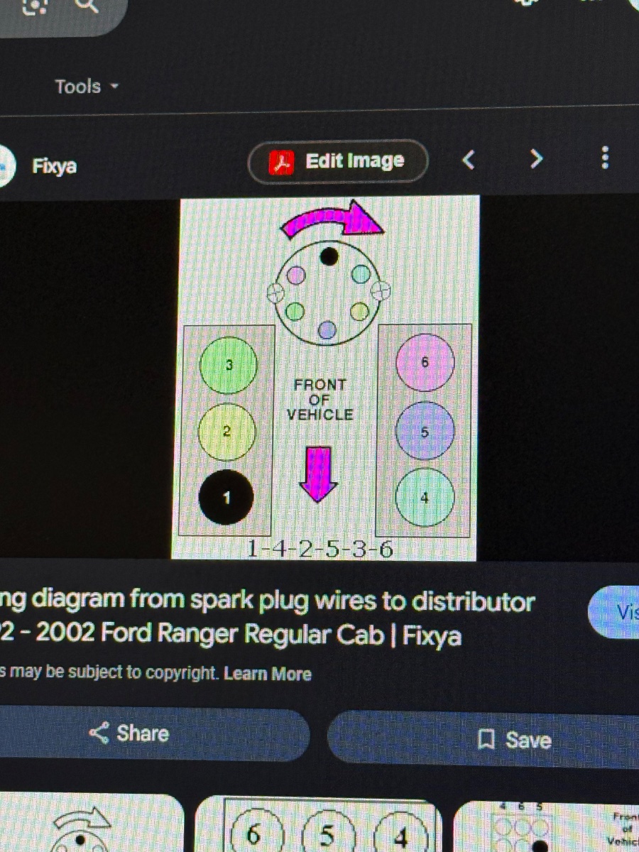

Here’s a diagram of how I have them wired. Wires are fine, plugs seem fine as well although I did notice the spark was a little on the orange side, would this be a cause for the symptoms described above?

That looks like a color version of the same diagram that's in my Haynes manual. Should be right.
Orange spark is a little concerning. It's harder to spark under compression. If it's orange in open air it may not work at all under compression.
Could be literally anything in the ignition system. One weak connection. Coils usually just stop altogether. I'd think the ignitor module would be the same way. Maybe condenser? Not sure about that.
