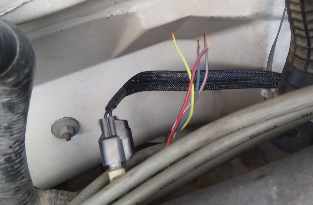

Another step in my struggle with my 2004 Ford ranger 3L. The picture is near the firewall aft intake manifold.
I need to map the wires from the replacement oxygen sensor RECEIVER.
Not the front oxygen sensor. The oxygen sensor receiver PLUGS Into the oxygen sensor.
Picture (on right) shows where pcv valve really is. Finally got truth when local Napa no longer carried it in stock.
The receiver wires are black, pink/orange, black/white and green/red.
How to map wires to those in picture?

Ok not receiver. It's a harness.
But I found http://computingzone.net/files/04_ford_ranger_complete.pdf p21 fig. 16: 3.0L, engine performance circuit 4/4.
Look at bottom right most oxygen sensor has correct colors.
Another article from stackexchange.com suggests that the black wires are heating elements.
Ok, how do I test the other wires. Most importantly where does the 2nd multimeter lead go?

It's the oxygen sensor HARNESS being replaced NOT THE SENSOR. The original sensor and harness merged from heat.
The wires pictures above are from the HARNESS.
I am mapping the harness wires pictured to the BLACK , BLACK/WHITE, GREEN/RED and ORANGE/RED OF the HARNESS Head.

Wires in the picture are:
red/black
green/red?
grey/purple?
yellow/grey?
And you are trying to match them to BLACK , BLACK/WHITE, GREEN/RED and ORANGE/RED
Black and black/white harness wires are Grounds and not associated with O2 sensor wiring, so are you sure this is related to O2 sensor
A response to a mechanics.stackexchange.com posting (52115 at bottom) said the black wires are for heating the oxygen sensor upon startup.
Which of the first picture's wires would map to these heating elements?
What are the other two wires doing?

That's what I was trying to describe, how to determine the engine side of the harness regardless of wire color. I failed, sorry.

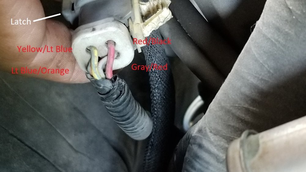

Harness side connector for driver's side upstream oxygen sensor, Motorcraft (Ford) WPT-807, $29 rockauto. Refer to my pics. What a pain in the a** to get to for repairs. Make sure you strap that new one down! You have the same year and 3.0. Looking into the end of the connector with the latch (wide square part) on top, pin 1 is top left, pin 2 is bottom left, pin 3 is bottom right, pin 4 is top right.
Pin 1- Yellow/ Light Blue stripe
Pin 2 - Light Blue/Orange stripe
Pin 3 - Gray/Red stripe
Pin 4 - Red/Black stripe
Verify wire colors on this one!
