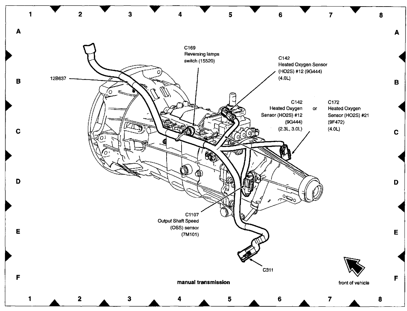

Hello everyone!
Got a question, can anybody share photos or take a photo of the wire harness routing that goes above and around the transmission and where things connect too? I took my harness out to rewrap it and forgot to take photos and now I can’t figure out how the cable magically stretched to all the needed connections
maybe the starter wire harness routing at well, let me know. Searching for photos haven’t been super helpful in finding anything so if anyone could take a picture of there setup that would be perfect. Thanks everyone!
