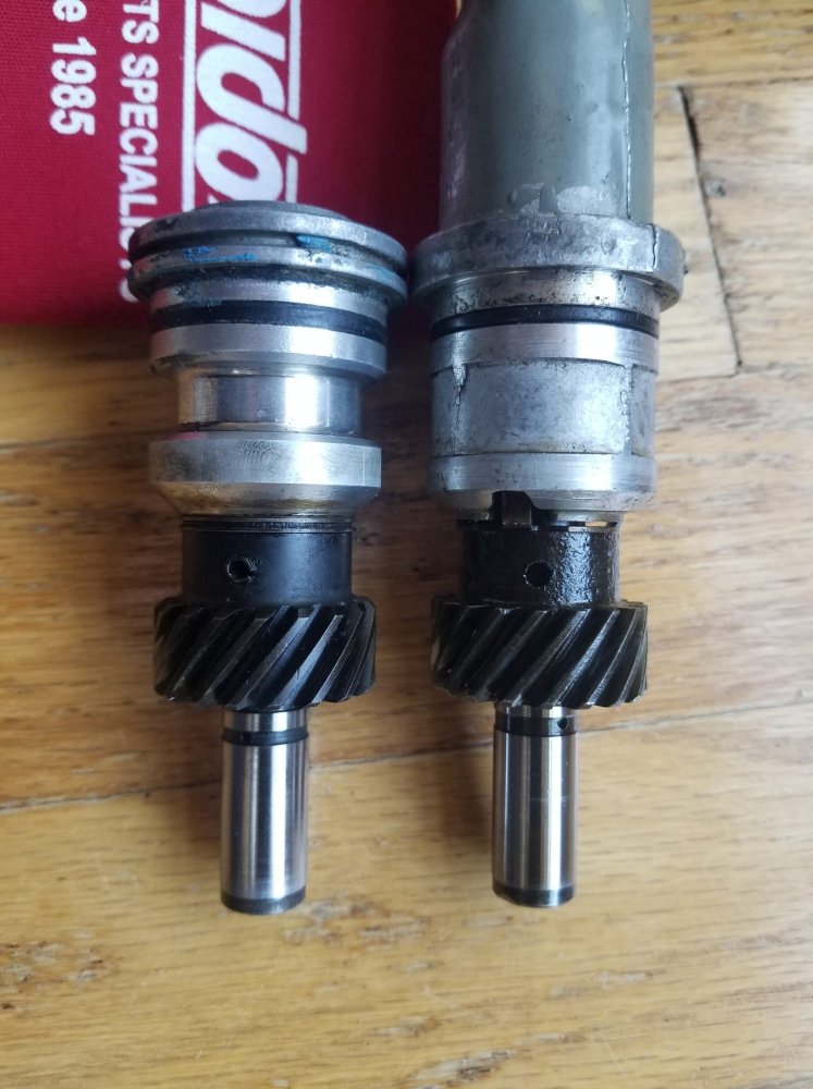

The 4.0 camshaft does indeed have a cam drive 'gear' on the back, just like the 2.9 and the 4.0 uses a blank oil pump drive, driven off the cam gear to rotate the oil pump. The 2.9 has this exact same setup to rotate the oil pump AND the distributor shaft. These setups are basically identical (see picture below - 2.9 distributor on the left, 4.0 oil pump drive on the right.) I have installed a 2.9 distributor on a 4.0 on an engine stand, rotated the engine and verified that everything works properly.
Bumping this thread from the dead! Below is a 2.9 distributor and a OHV 4L oil pump drive "plug". I'm trying to do the opposite of what is suggested in this thread - I want to run the 4L part in the 2.9 as part of a conversion to distributor-less using EDIS. However, the 4L plug doesn't seem to go all the way into the 2.9 block - it stops about 3/8" short of the bottom. Everything seems to measure out the same, just as "Bird" suggested back in 2008.
What am I missing???
Is the hole in the bottom of the shaft the same distance in depth? Where the oil pump shaft goes.

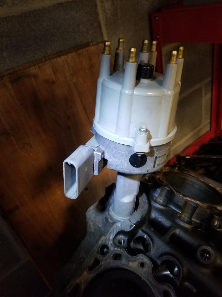

I can now confirm that a 2.9 distributor fits just fine into a 4L block with cam installed. Distributor rotor spins just fine when cam is rotated.

I should point out from my photo above, I didn't get anything to "work" - I merely dropped the 2.9 distributor into the hole typically occupied by the "dummy plug" on the 4L. Heck, I don't even know if it might fight for space with the intake manifold or something on a fully assembled engine.
