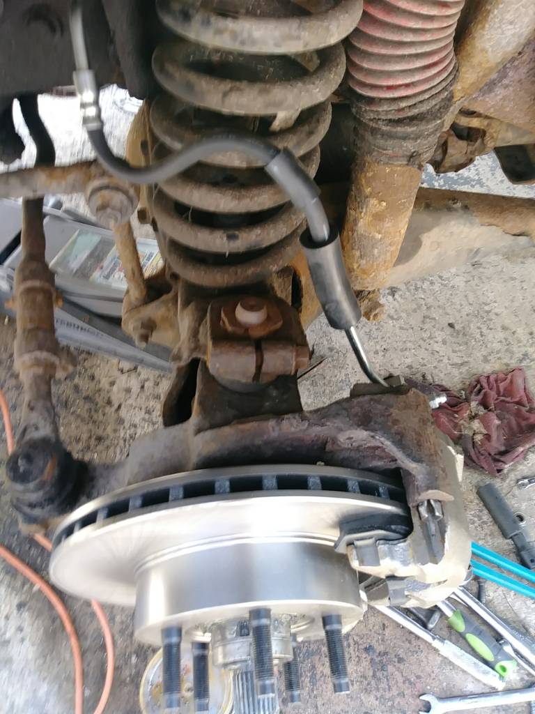

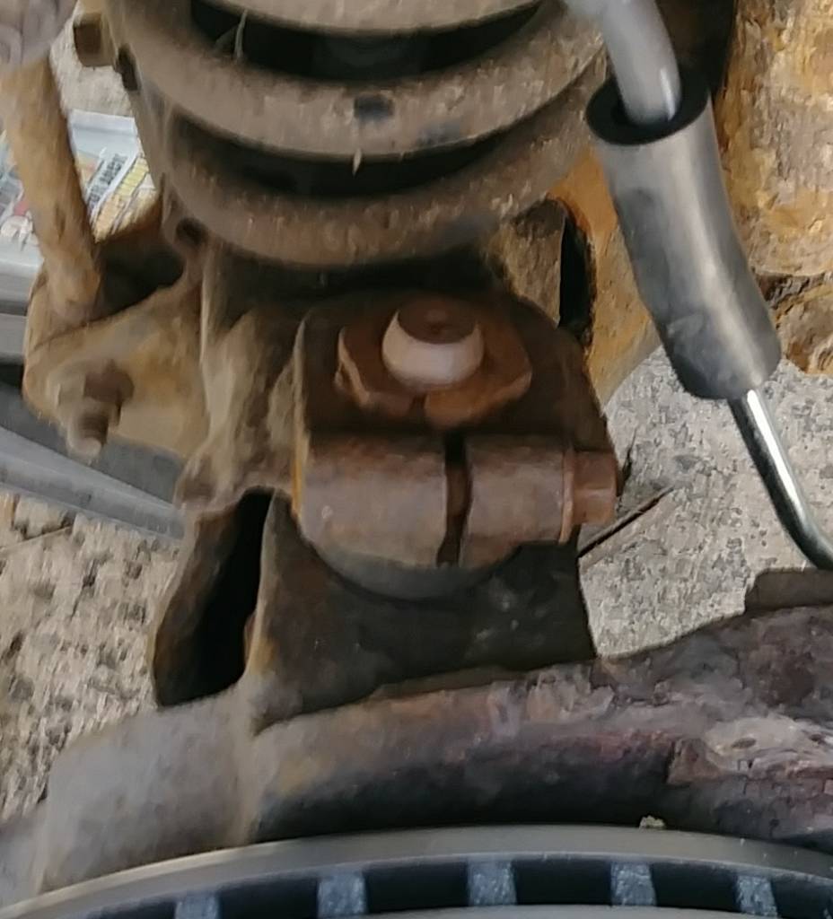

Here's a picture of the left side of my truck (driver's side)
The evil player in all this is that bolt called a pinch bolt The originals were 12 point head in a recess.
Once the bolt is loose a small chisel or wedge type object driven in the clamp loosens the camber bushing and it can almost be turned by hand.
