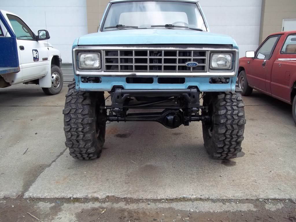

Yeah I was wondering, my first Toy had the push pull steering with that silly short drag link, sucked for drooping out the drivers tire, now I have the 8" axles under my 68 Land Rover with a ScoutII saginaw box doing steering duties, no bind yet, tho my short leaf springs don't flex near as much as what you have pictured.

How do you deal with the 4½" width difference between a Toyota and the Ranger? Is this something you do when reworking the housings? (in which case one or both of your shafts must be custom, which would have to add a little cost vs. off-the-shelf stuff)
I believe the land cruiser axles are wider than the pickups, not sure though.
theres also the landcruiser axles that measure out the same 59.5" with the 9.5" ring gear. this is what im working on right now and im using the landcruiser front axle mixed with the ifd trucks rear axle they end up the same width.
