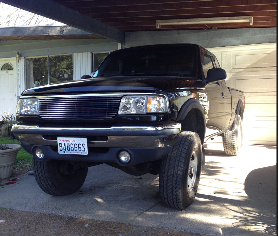

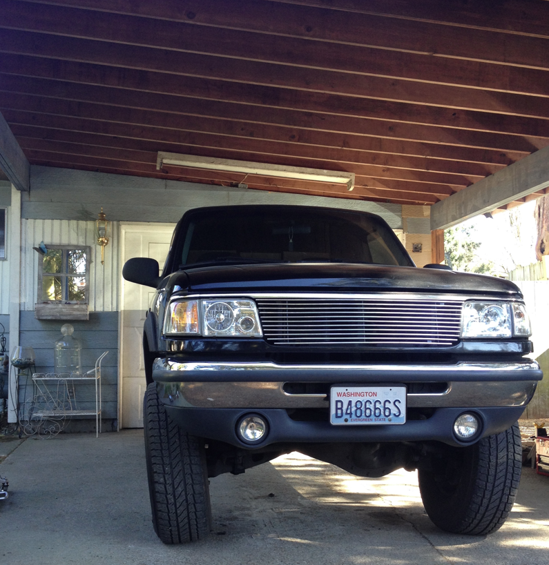

Just installed 4" lift springs and new shocks in the front and have some bad positive camber now. I just installed 4* adjustable camber/alignment bushings and am going to get an alignment down professionally. Before I even go in there do you think 4* will fix this positive camber or do I absolutely NEED drop brackets? I don't know what a 4* difference in camber will look like.
Don't want to waste time making an appointment if they are going to tell me they can't get it into spec.
If not, are there any alternatives to drop brackets? Just don't want to spend another 200$+ right now.
Thanks

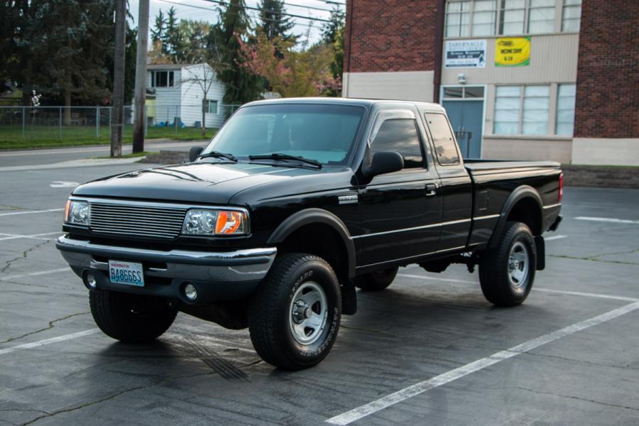

Update
Thank you all for the help, finally got her done.

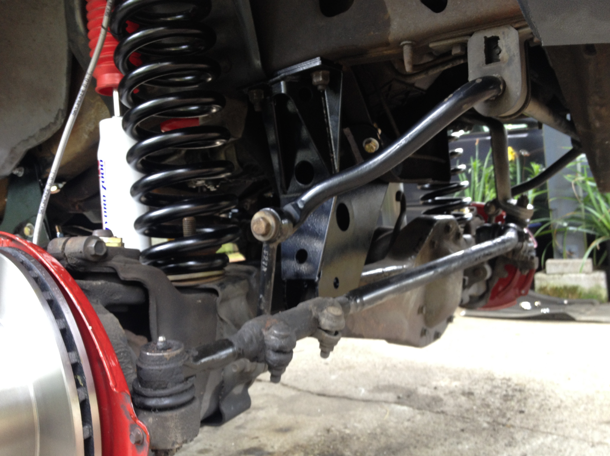

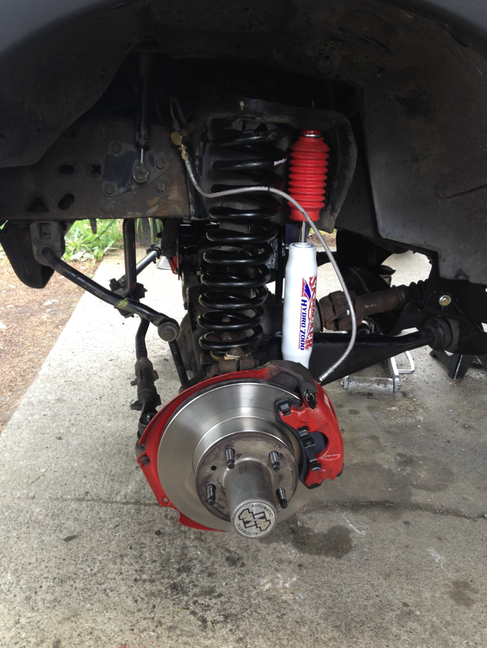

Used 4" coils and 1" coil spacers in front. Removed rear blocks and replaced with 5" blocks instead of stacking (2) 2.5"s. Installed Skyjacker dropped pitman arm, drop pivot brackets and radius arm brackets. New shocks all around, extended stainless steel braided brake hoses and 06+ emblems.

Looks good :icon_thumby:
You might try moving the driverside axle beam to the upper bracket hole, this should improve your clearance under the diff & beam, and make the frontend geometry a bit better as well.
You know, I'm glad you said that. I assumed I needed as much drop as possible to fix the camber so I chose the lower holes and didn't think twice about it. When I had the alignment done, the tech said he had to max out one of the camber bushings to get it into spec. Both front tires are sitting with negative camber now (within spec), so when the springs settle it's going to get worse and the bushings will already be maxed out. Glad I have that another hole to use :icon_thumby:
I'll be changing holes this weekend. Im assuming I should do it to the passenger axle too?
Your passengerside beam didn't look quite as bad (for reasons unknown, Skyjacker's brackets have their holes at different positions for passenger & driverside beams (driverside having more drop). However if your passengerside camber bushing is set for significant positive correction, then go ahead and move it up as well (best to have the bushings closer to a neutral correction setting than having one or both near max).
