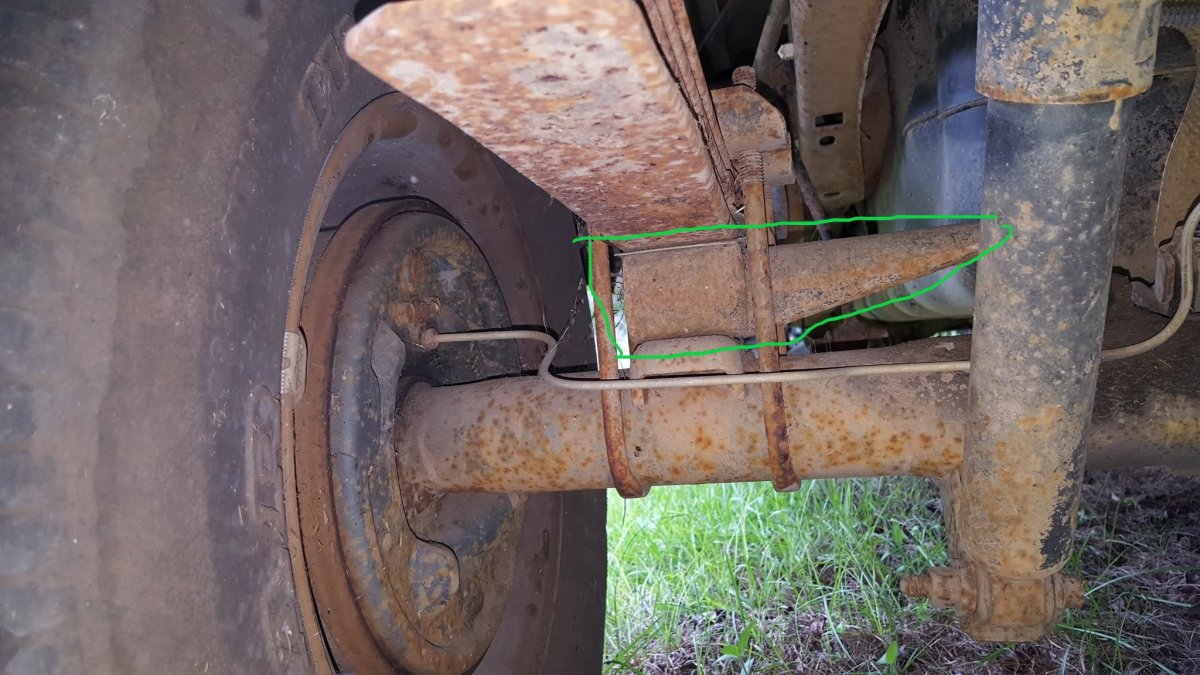

@Lefty, I think you're a little confused as to what a "body" lift is. I'm no expert either, but MY 2001 2wd Edge has lift blocks on the rear axle that lift the whole truck, but not the axles. I think this was part of the "Edge" package. Below is a picture of the blocks that rais the rear. The front is torsion bars, so a twist one way will lift, a twist the other way will lower. also a completely stock 2001 2wd Ranger Edge

Well maybe "lift" is the wrong word.
I never found a decent Explorer axel, but I made some modifications. I pulled the two inch blocks out of the rear and replaced them with one's. I also lowered (turned down) the front torsion bar all the way maybe 5/8 an inch. My regular mechanic told me that those changes would make no differnce and not require any further modification. So I never changed the rear shocks They were just fine. Front shocks too. The fronts were pretty shot so I changed them to Monroe shocks. I can't remember the numbers, but they were what were recommended for the original and unmodified Edge. No problems. There was a slight improvement in handling.
